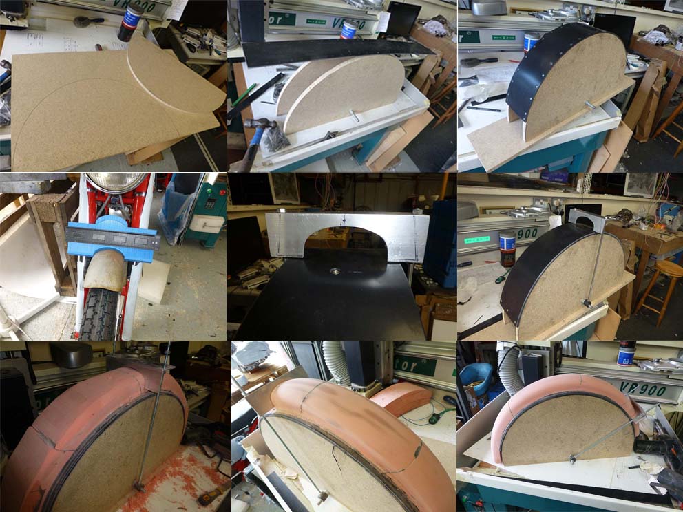

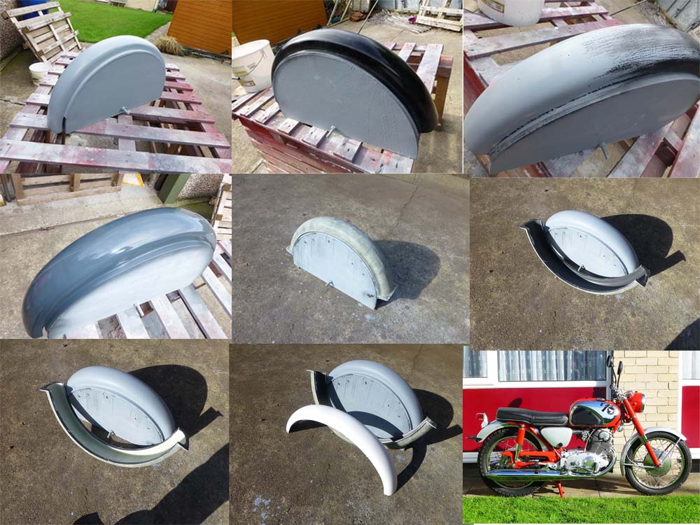

Well boys & girls, I said that I 'cheated' & would reveal all, so here goes!!
No where near Mr flatheads workmanship in 'tin-bending', but I, on the other hand have a degree in cheat!!
I measured from the wheel-centre to the outside edge of what little of the front guard I had left.
Cut out formers, & made up a basic shape, took a contour of the fender, & made an alloy shape/form, which was pivoted from the radius-centre, hi-density pattern-making foam was cut-glued & then carved to the profile.
Sanded, filled & primed, guide-coated & rubbed down smooth, waxed, & layed-up with GRP, to make a mould, the fender was then layed up from the mould, turned out not too bad actually, but the best bit, I made 2, just in case I cocked it up, & I still have the mould to make more if need be!!
OK, so its GRP & not 'genuine' you got to look hard to realise it though!
I used 4mm stainless dome-headed capheads, penny-washers underneath & nyloc nuts, for the bracings & they look almost the same as the original rivets.

Model man I worked some 40 years in fiberglass pattern making moulding including working for Screen and Plastics in Birmingham UK I worked on the BSA/Triumph 750 3cyl racer fairings seats also the Norton racer yellow tank and seat and the Vetter Tri 3 tank seat unit the one with the 3 pipes down the side and so many more.
Any way on my Triumph 5ta I have a fiberglass rear chain guard and number plate in some 40 years of owning it no one has spotted the items.
You have made a nice job of them well done did you use silver pigment in the gel coat or did you just spray it silver ? .
GMan put us onto a great silver rattle can Simoniz Wheel Silver Spray Paint it is acrylic and works well theN lacquer it.
