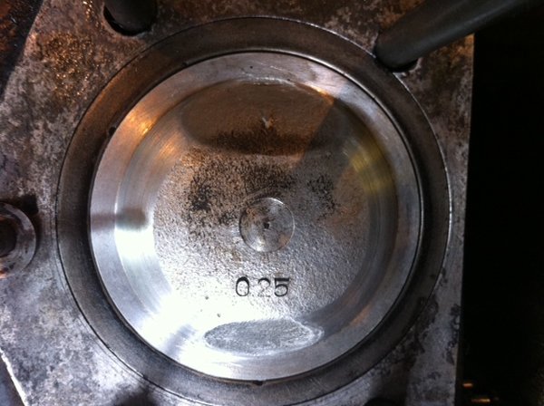

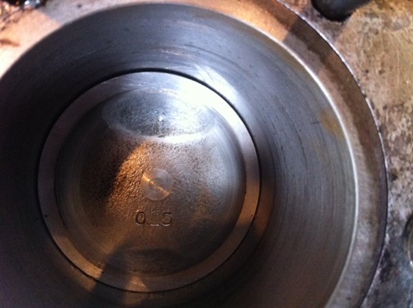

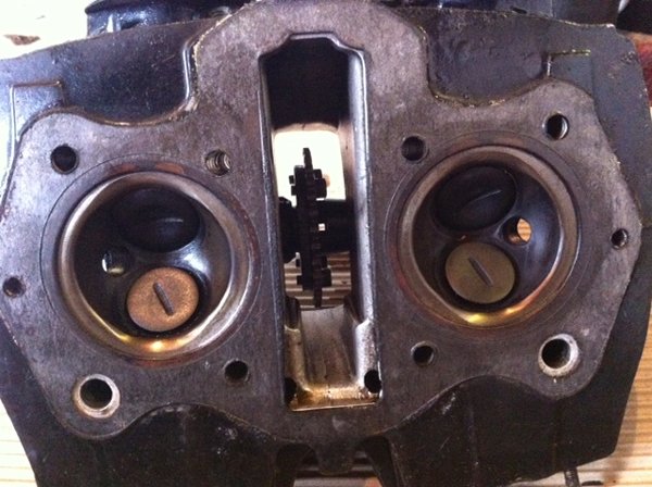

Started the strip down of the engine and this is what I have so far.
The bores measure 64mm with very little wear at all.

Thanks for the pictures. Looks like a hand-modified CB72 (250) head with modified pistons from a CB350. The bore should measure 64.25 with those pistons. Valves look to be standard.

Well to be exact 64.25 x 54.0 gives 350.15cc
I would think it would be still classed as a 350.
It might have a long-stroke crank but you would probably find a plate under the barrel if that was so.
