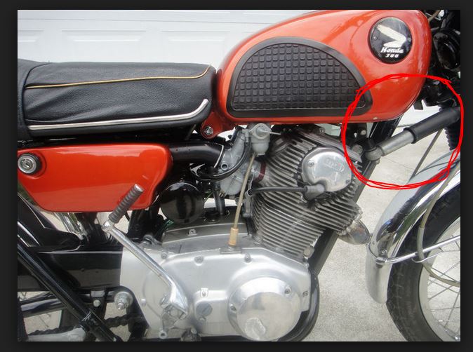

So, I'm currently working on a parts list excluding the internal engine components I may need since I still havent had the time I want to open it up. :( There is one part that I cannot identify, it looks like a shock absorber attached to the engine and frame. What the hell is this thing called?? See pic...
R100
Posts: 332
Post by R100 » Tue Mar 24, 2015 1:29 pm
Steering damper.
