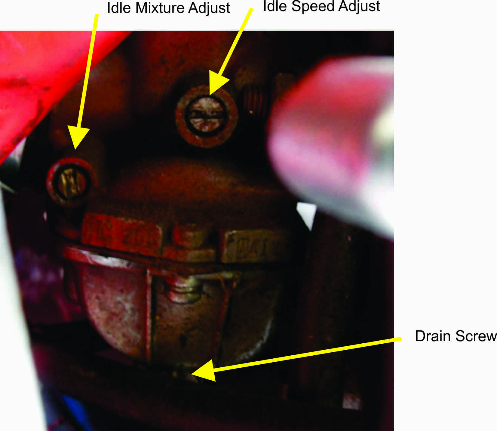

2. In the pic there is an Idle Screw which sets the idle speed. (This is not one you screw all he way in and out 2 turns). Once it is running you can turn this screw IN to increase speed and OUT to decrease speed. The Idle Mixture Screw adjusts the air available at idle. ThIs is the one that you turn all the way in and out a couple of turns. Once you have the idle set and the engine is warm, then use this screw to smooth out the idle.
Also in the pic (barely visible) is the drain screw. This screw can be removed to see if fuel is flowing to the carb.
I suspect your neighbor turned the Idle Screw all the way out which means it will not idle at all. So when trying to start open the throttle just a little bit and then kick. If you loosen the drain screw you an see if gas is getting tho the carb.

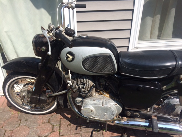

Here are some pics..
I know the bike needs some cosmetic help but everything else is pretty clean. I know I need a fuel filter, im in the process of getting one but besides that, the bike was running when my mechanic played with the screws it stopped running and wouldnt start anymore. Should I take everything out and start over? I'm really at a loss here. Not sure what else I can do... :(

DO NOT run it again until there is a fuel filter.
Yes you are going to have to look carefully at the carb again. There is a very small jet in it that is used at low speed and idle. When you put it together also check the float level.
Just turning a screw, unless it was the Idle Screw would not stop the bike from running or prevent it from running. If the Idle Screw was all the way out it probably would not start and only run if you gave it a bit of throttle.
There could be other reasons but start with the obvious. If you had a bit of rust floating around in the tank then while you were riding it stayed agitated and didn't find it's way into the fuel system. Once you stopped the particles settled and found their way into the carb (maybe). Anyhow need to eliminate this problem before continuing.

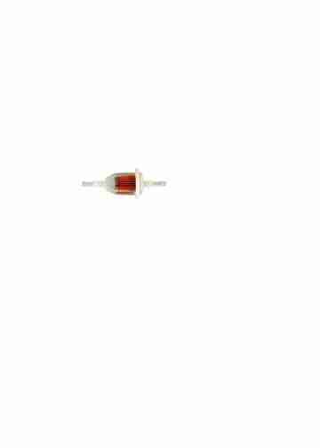

DO NOT let this mechanic touch it again!!! (Fuel filter pic)
- filter.jpg (2.06 KiB) Viewed 3874 times

I saw a similar one like that at autozone it said it was universal but when I got there the guy on the register said it wouldn't fit. I feel like every person I talk to just confuses me more. How can a universal fuel fit not fit my bike!!!! When I do get the filter what's next take out the carbs Do I strip them completely or just clean it with air. Empty out the gas tank? Adjust the throttle cable again?

The fuel hose on your bike is smaller than the ends on the filter - need to find one that fits your fuel hose - NAPA or lawn mower shop.

Doing anything else until this is correct is waste of time and so is running without a fuel filter. Snip a 1/4" piece off you fuel line and take it down to an auto parts and find a small inline filter that will work.
