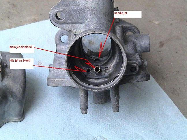

are you sure the air bleed tubes in the carb inlet are clear all the way thru to the jet sockets and idle mix screw socket?

I'm using the original style air cleaner that I bought last year. It looks a little dirty but very minimal but I did take some compressed air yesterday to blow out each fold. Are the tubes coming out of the two holes on the front left of the original style air filter suppose to attach to the anything? I currently have them running out the side of the frame. Are the 2 nipples on the backside of the engine need to be attached to anything? Running original exhaust pipes with brand new baffles that I cleaned the other day. I did inspect all the carbs openings and everything appeared clear but where exactly is the air bleed tubes in the carb inlet? My thoughts are to replace the air cleaner, hotter plugs, and adjust the float to 28. Thoughts???
Post by brewsky » Thu Sep 19, 2013 10:02 am
Try running without the air cleaner attached (just not on a dirt road) and see if there is any difference.
Here are the air bleed openings:

Those aren't your issue with running rich and they have nothing to do with the air bleeds pictured by Brewsky which may cause a rich condition if blocked. If you want to clear those, you should remove the bowl, jets, and idle mixture screw, then send a tag wire down there with a little compressed air.
