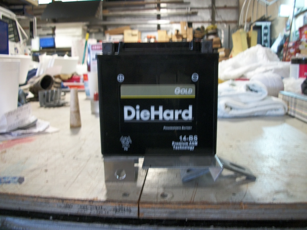

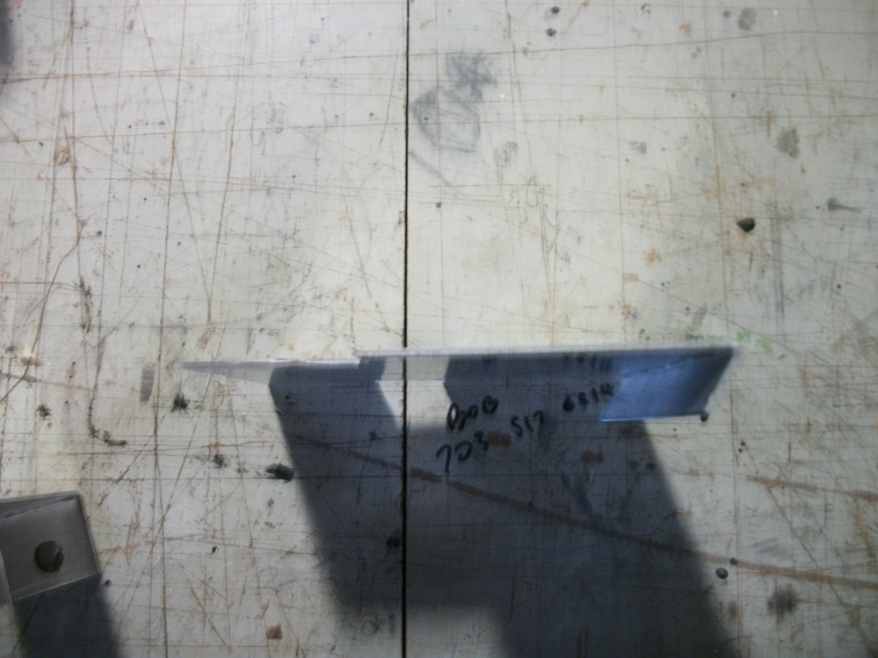

To houseowax, in my pre 1965 dream, I removed the stock air cleaner, put on a universal one, built a custom battery tray out of aluminum and attached it to the two rear engine mount bolts. I then made a larger hole in the battery side of the frame in order to insert a larger diehard 14-bs battery. It really works well and cranks the bike over great. With the ricks motorsports stator and a battery tender I intend it to last a long time.
The new battery
The new battery
Top view of tray.
Top view of tray.
Side view of my tray.
I riveted this bracket to the tray to attach it to the engine bolts.
