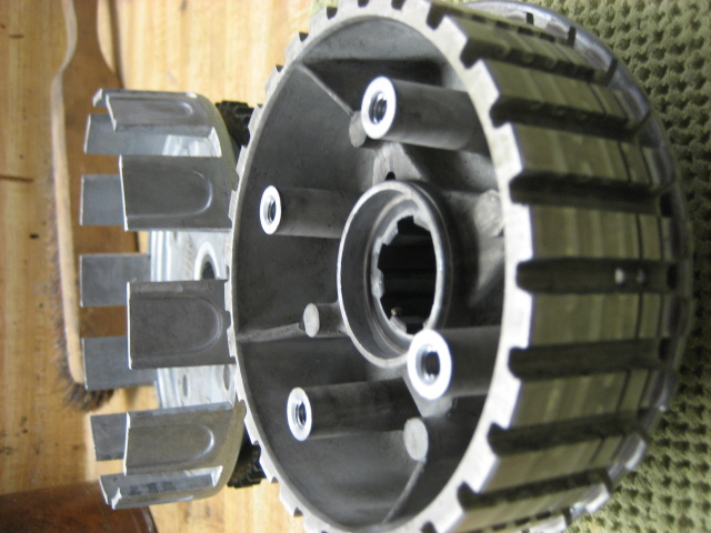

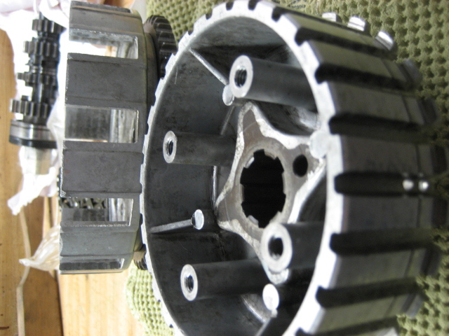

Even better, I found what I believe is a Cush clutch setup on Ebay, although I could be wrong about that. Maybe someone can confirm from the pictures. It also came with the thick first disc and aluminum core plates and the two wires. There is absolutely no wear where the plates touch the basket, and along with the overall condition I think it had low mile useage.
I'm not sure about the clutch springs. I have two sets, the ones from the old clutch have .115 inch wire (but no white paint) and the ones with the new clutch have .104 inch but are slightly longer. I think I'll go with the heavier but shorter ones.

New parts are Cush Drive and do use the shorter springs. .............lm
