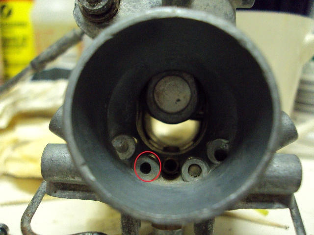

Another question, Where does the hole with the red circle go too? I've been trying for a couple of hour to clear the passage but can't seem to get it cleared, want to try to clean from the other side but not sure where it leads..
Tried to check on the other carb but it too seems to be clogged...

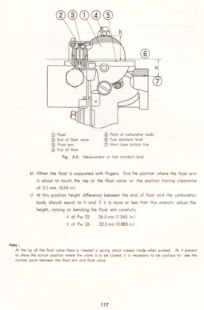

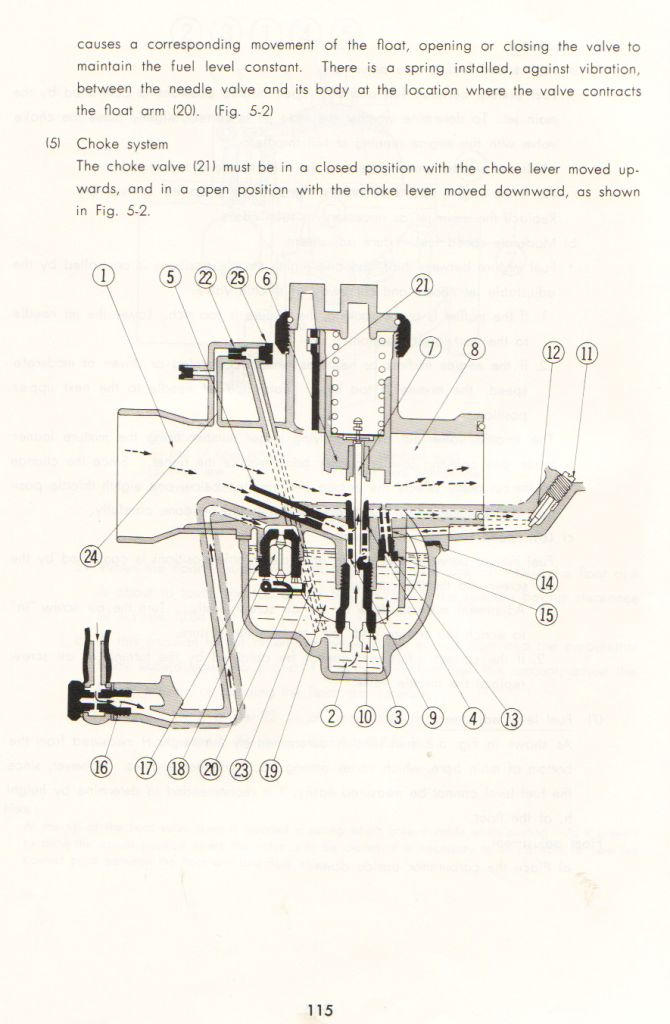

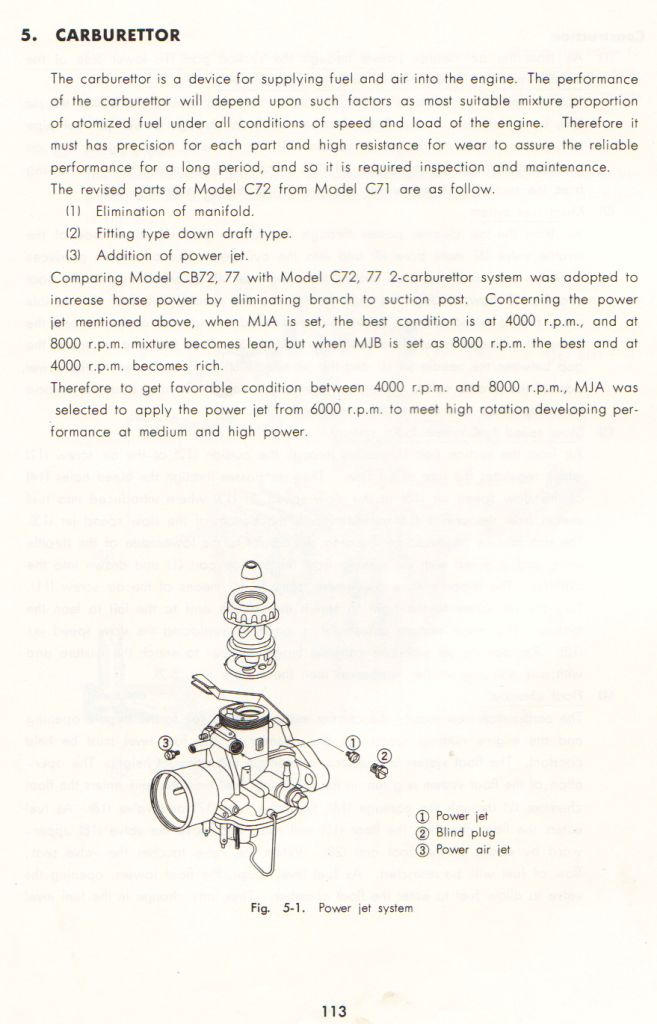

Can't shed any light on that one, but see if the following extracts from the Honda shop manual help. Remember that the Power Jet system refers only to the PW22 carbs fitted to the CB72. Perhaps that's an undrilled passage in the PW26?Styleisdead wrote:Hey Steve, Yeah, it looks just like that... I wouldn't be surprised, the bike's been sitting since the 70's...
As for the picture above, whats the chance it doesn't lead to anything??? Every other hole I can find, blows through, grrr... Well I'm going to keep at it for a little while longer, then put it back on and see how it runs...
Joel
Gunner_CAF
- Posts: 316
- Location: Wisconsin, USA
You can many times trace these if you study the carb close. The channels are all straight and look to be drilled from the outside of the carb body. Where they turn, you will see the ends plugged, and another channel running a different direction. Most times you can get an idea of where they are going.
Gunner
Gunner
