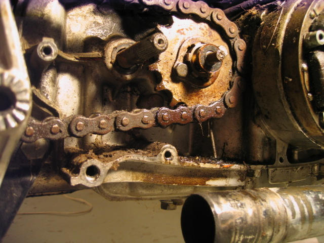

There's no sense continuing to find out why I can't get this bad boy to fire if a pool of oil collects below the motor when it's just sitting there, so I continued my efforts to get the right side crankcase cover off. Another trip to Sears netted me the impact driver set and after a few whacks those last two screws succumbed. Pulled off the cover...was a little worried about the spring so I teased it out as I pulled off the cover. Wasn't sure whether or not the kick starter pinion was supposed to be pulled at the same time but it was easing itself off the shaft. I don't like springs. Too many lawnmower and chain saw repairs have caused me to think dark thoughts when I see a large recoil spring. Anyway the pinion came off and the spring made an impressive and alarming SPROING but it's still attached to the cover so it looks like everything will slip back on.
After removing the case cover, a cursory review revealed that the oil seal around the clutch lifter rod is not seated. It is a good 1/4" proud of the recess where it should be seated. I'm assuming this seal out of position means it was doing a damned poor job of preventing oil from migrating from the engine to the ground. The PO had predicted this oil leak was due to the other oil seal in the area, namely the one just rearward which my parts manual states is at the end of the counter shaft. I'll replace the former oil seal since if it likes to float around now there's a good chance it'll not stay put again if I just try to shove it back in.

Here's a pic of what I saw just after removing the crankcase cover...the "bad" seal is clearly in the wrong spot and the other seal is dry as a bone.
As usual any suggestions, comments, or pithy remarks on my progress are welcome.

Congrats on getting crankcase off. I highly reccomend picking up one of the Allen replacement sets of screws for the crankcases that are floating around the internet. Just search "Honda CB77" on eBay and you'll find it among the results. The Phillips head screws aren't very preactical and just strip too easy. Besides, if you ever want to make it show worthy you can always replace the screws with the "correct" type.
That chain sure needs quite the cleaning!! I reccomend the grime minister chain brush. You can find them on Cycle Gear's site, or most bike shops. It does a great job of tearing away all the buildup.
