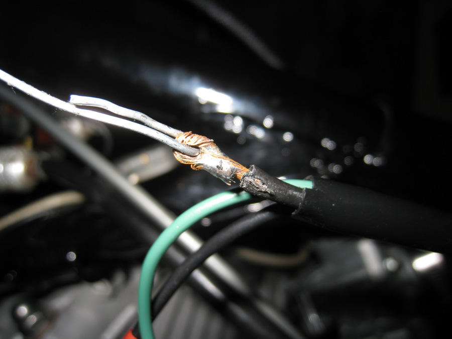

so im on to the wiring harness once again and finally figured it out with the help of ( e3steve, superchicken, and gunner http://www.honda305.com/forums/viewtopi ... sc&start=0 ) thanks for the help much appreciated. well on the journey of hooking up the wiring harness, shedding as many wires as possible, and re-covering everything in nice tubing i stumbled across a nice way to fish wires through new harness tubing. just solder either 2 to 3 wires together, make a hook with some steel wire and feed and pull through. on a single wire just make a loop, solder it, hook it, and pull through. hope this tip helps somewhere out there it made my life easier.
-cheers
-deez

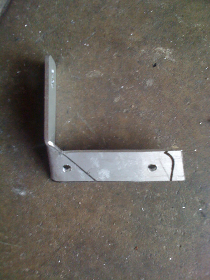

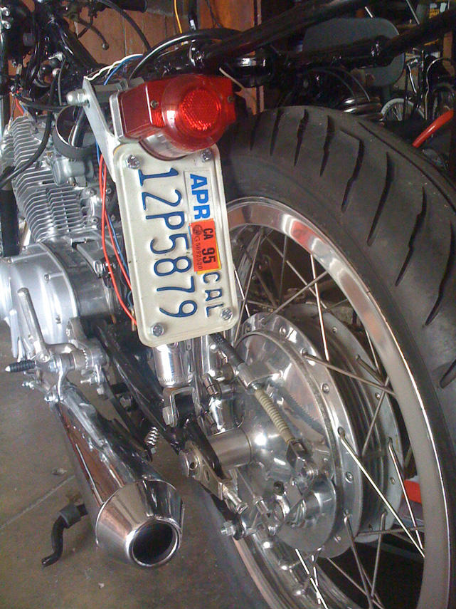

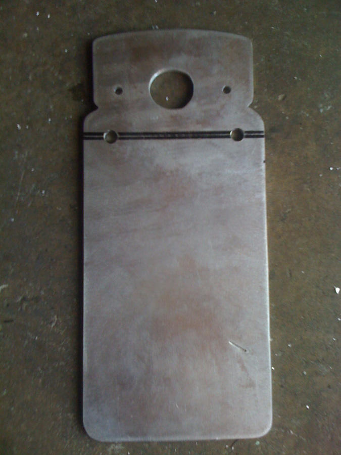

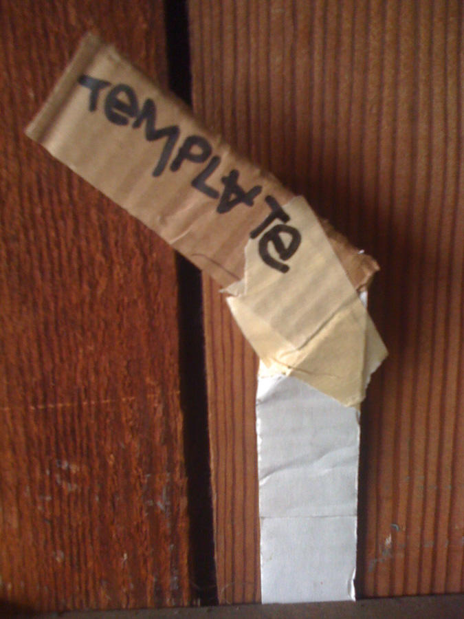

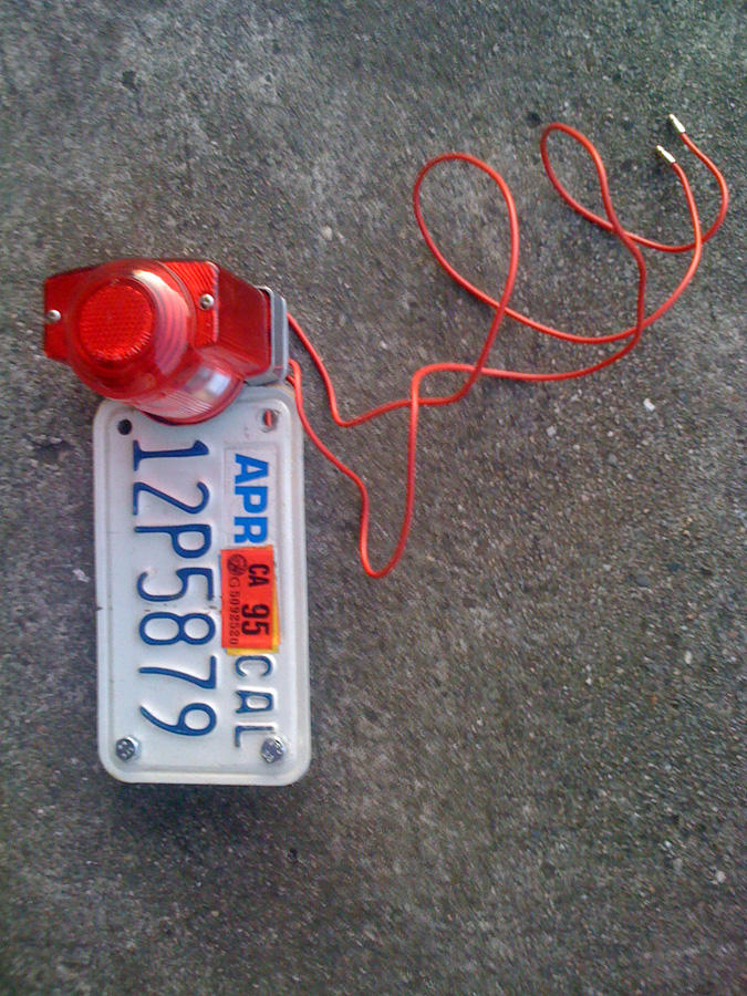

a few shots of the license plate and tail light bracket i made out of some scrap aluminium ( davomoto's was the inspiration). will post some shots of it on the bike this weekend

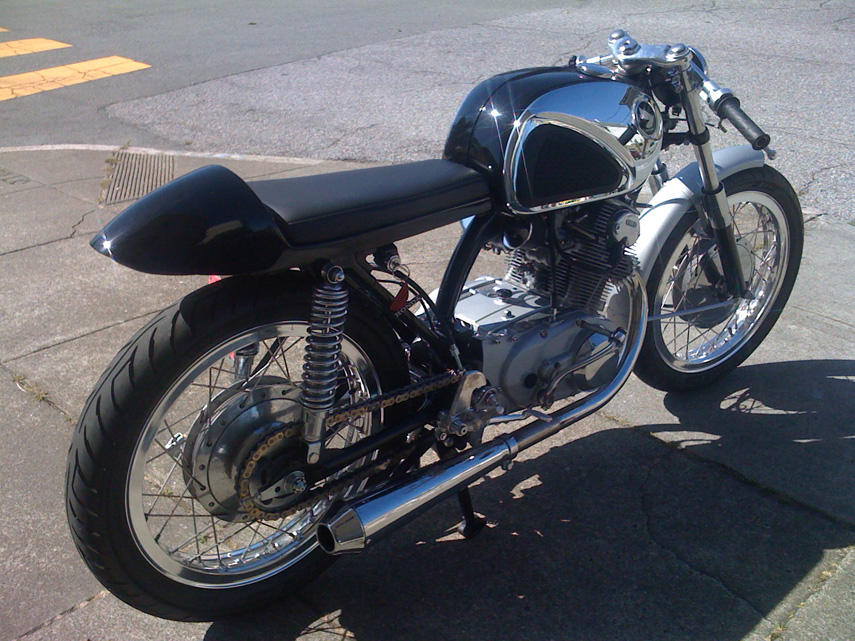

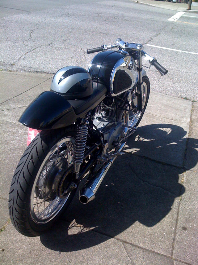

a bit more progress and some photos from my phone.
-cheers
Post by e3steve » Wed Sep 09, 2009 12:54 am
Lookin' really sweet, Deez! Love the reverse-cone megaphones -- sheer nostalgia; a pal had those on his '68 CD175 when I first started biking in '70. Always sounded lovely to my ears.

Post by deez » Wed Sep 09, 2009 4:11 pm
thanks steve and thanks again for all the help. yeah i love those reverse megs, every time someone hears it they cant believe its only a 305. those things have a great sound indeed.
