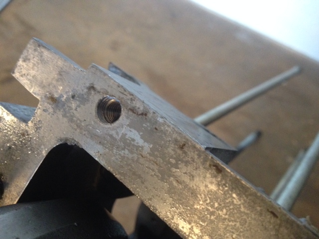

Helicoil for the stripped case threaded hole went in just fine, and it gives me peace of mind knowing these steel threads are just as strong or stronger than the original threads.
Now its time to seal the cases back up!

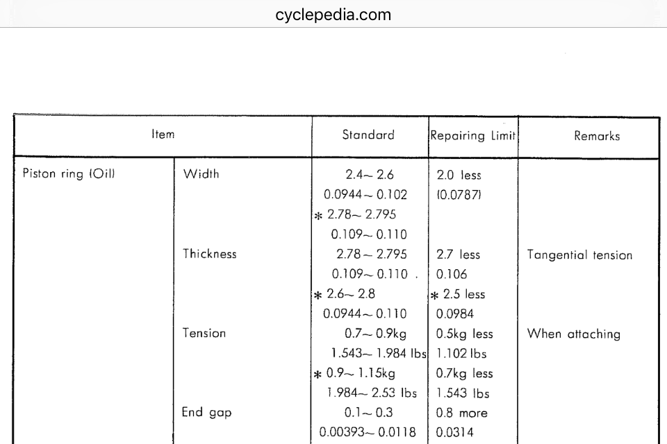

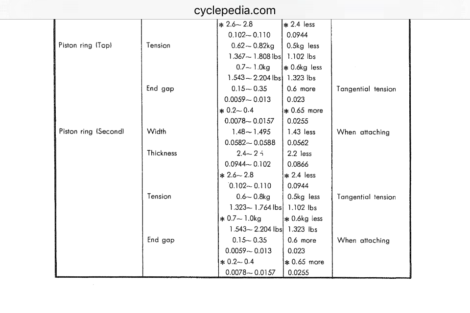

Ok, if im reading correctly, and after sitting down in front of the Honda repair manual, my notes, a pen, and no beverage, I've done some learnings:
According to Honda, my CB77 with a standard bore top ring should have a maximum .4mm ring gap with a repairing limit of .65mm. .4 + .65= 1.05mm gap before I have to replace. My top rings are .60mm and .65mm, so Im good.
According to Honda, my CB77 with a standard bore second ring should have a maximum .4mm ring gap with a repairing limit of .65mm. .4 + .65= 1.05mm gap before I have to replace. My second rings are .65mm and .65mm, so Im good again.
According to Honda, my CB77 with a standard bore oil rings should have a maximum .4mm ring gap with a repairing limit of .8mm. .3 + .8= 1.10mm gap before I have to replace. My oil rings are .65mm and .70mm so Im good again'er.
BAM!!!!
Mind....
Blown....
Please correct me if I've misinterpreted the ancient Honda scrolls.
BAM!!!!
Mind....
Blown....
- IMG_0361.PNG (109.47 KiB) Viewed 1880 times
- IMG_0362.PNG (42.19 KiB) Viewed 1880 times
