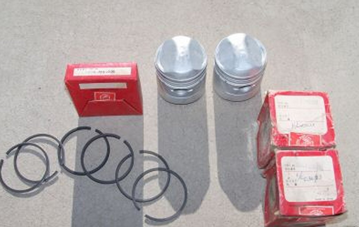

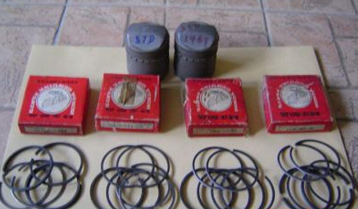

jensey
Posts: 384
Location: Netherlands
Post by jensey » Mon Oct 27, 2014 1:40 pm
Hi Graham,
Maybe I can help...
need these.jpg (94.15 KiB) Viewed 3633 times
or these.jpg (99.26 KiB) Viewed 3633 times
Post by G-Man » Mon Oct 27, 2014 1:56 pm
Hi Jensen
Thanks for the info. I cannot read the numbers on the boxes. What is the difference between those two sets?
jensey
Posts: 384
Post by jensey » Mon Oct 27, 2014 2:22 pm
Nothing I guess, both sets are H/C pistons with rings, numbers are 010's
