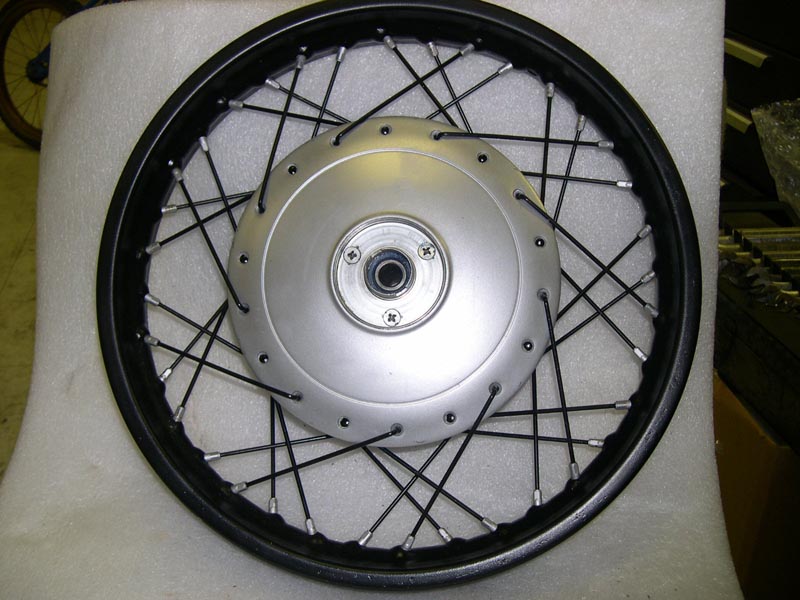

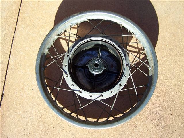

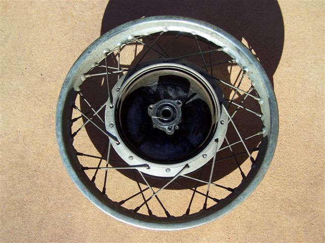

The original wheels are also in pretty good condition. Not sure what to do with these, but I'm really impressed with what 3BeanCrispy achieved with his wheels.

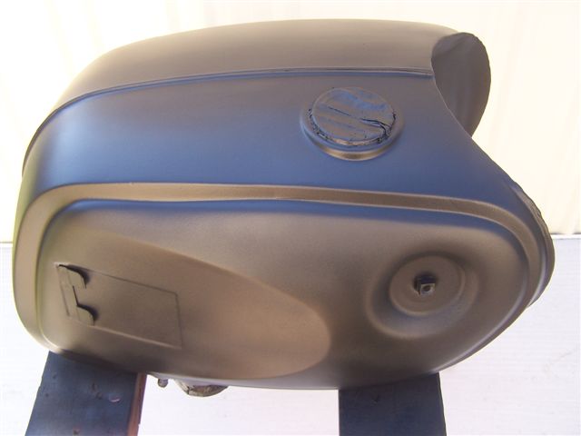

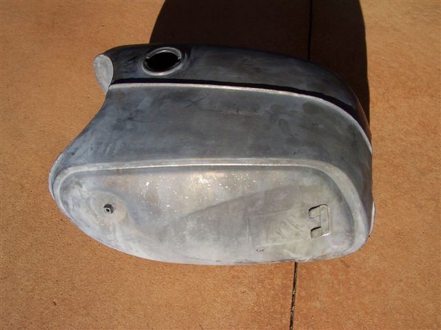

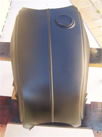

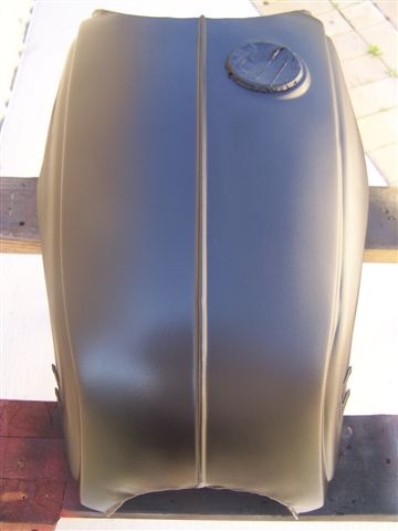

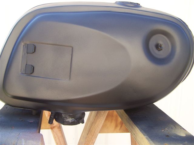

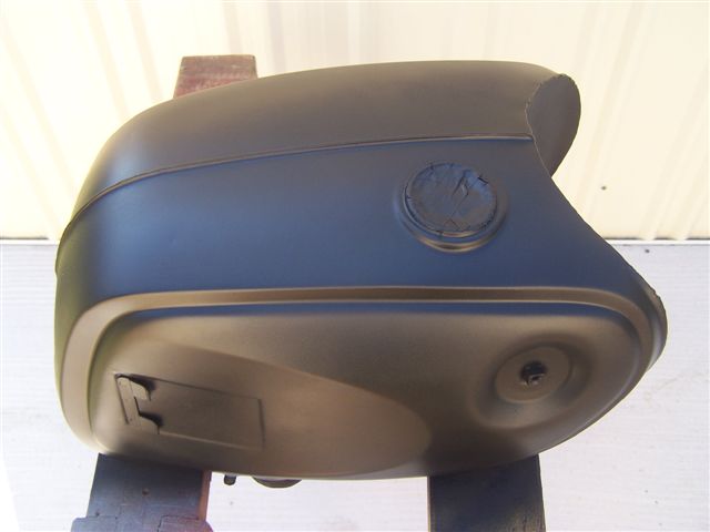

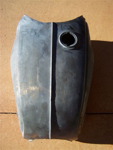

I've lined the 2 fuel tanks with red coat and rattle canned these satin black. The tanks were in pretty good condition so I didn’t really fill any small dents or scratches. I'll also do the frame satin black with a lot of the trim powder coated gloss black and gold - hoping this will look pretty good.
I did learn something important today – I’m not much of a spray painter, but the satin black is relatively forgiving and does hide a lot of imperfections. The finish is a little orange-peeled, but will be just fine for the “rider” I’m planning to end up with – it certainly won’t be show-bike material.
Attached are a couple of photos of the (nearly) finished tanks. Yes there are 2 different tanks I’m preparing and thanks to mike1969 I’ve got another set of tank rubbers.

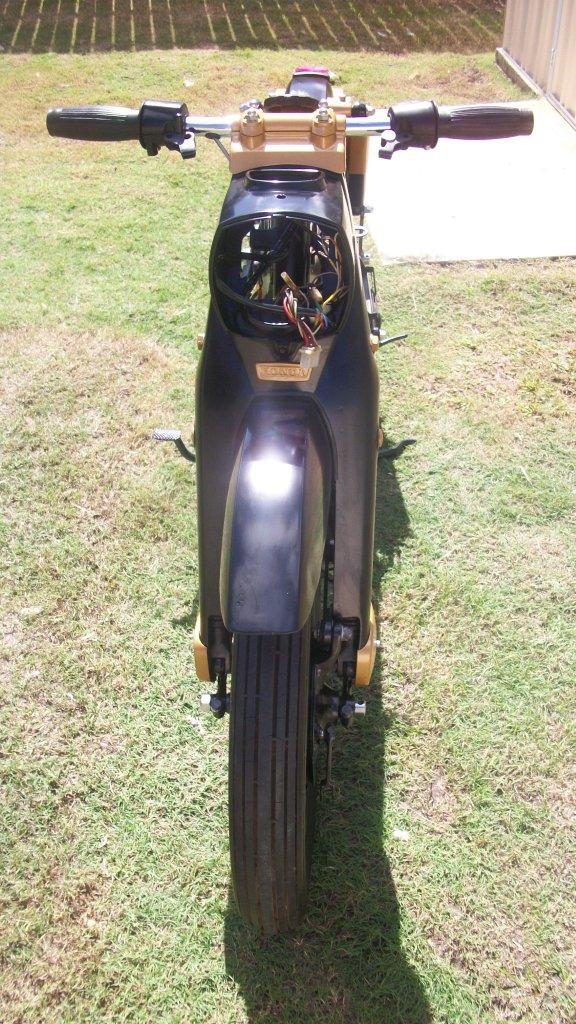

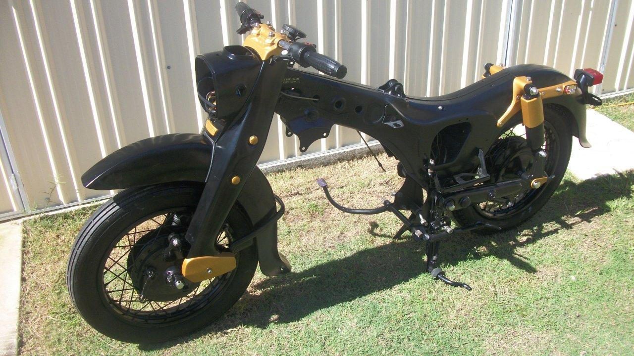

G'day Guys

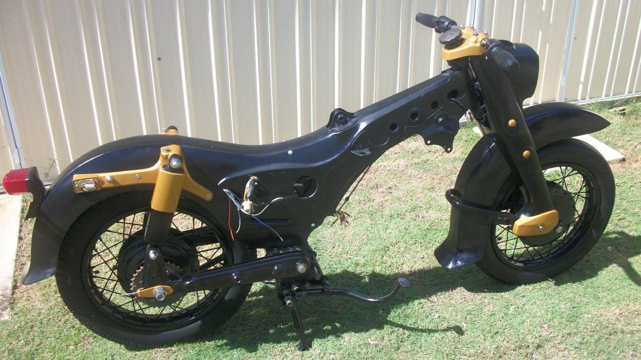

Well finally got to the rolling frame stage. I'm pretty happy with the way things look, even though it is a bit rough in places. But given it is a combination of powder coating and rattle can - it looks OK.
Still a few little things to fix up with what you see, but on the way to looking alright.
I will put the rest of the frame components back on and then start on the engine. Really just want to lift off the head and check the rings and valves.

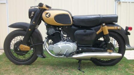

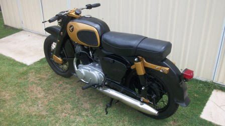

G'day Guys

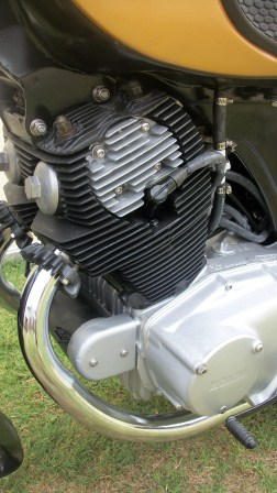

Well finally got all the bits and pieces reassembled. The engine looked good, with the pistons, barrels and valves all in good condition with no real work required, so just reassembled her with all new seals, o-rings and gaskets.
Yesterday I had some problems with the 2 fuel taps I had, as they both leaked after being re-kitted and the fuel tank filled, but eventually got one to work after a bit of fiddling. Unfortunately, the fuel leak did damage some of the high temp crankcase paint (that I thought would have been fuel resistant?).
Anyway, I wheeled the old girl out into the open today and gave her a crank with fuel in the tank, and what do you know after a quick second she fired up and ran just like new. I let her idle then gave her a couple of low revs and she sounded very sweet - just like my other old girl all those years ago.
After a couple of minutes I noticed a pretty savage oil leak from around the head gasket area. Looks like a drip or 2 a minute from the LHS and a drip every 2 - 3 seconds from the RHS. Looks like I'll need to pull out the engine and check it out. At least that will give me a chance to fix up the crankcase paint.
I'm just amazed the old girl runs, idles and sounds so strong for a 250.
Any thoughts and/or suggestions on the oil leak most welcome.
A couple of photos below of how she looks - still have to fit the lights, indicators etc.
