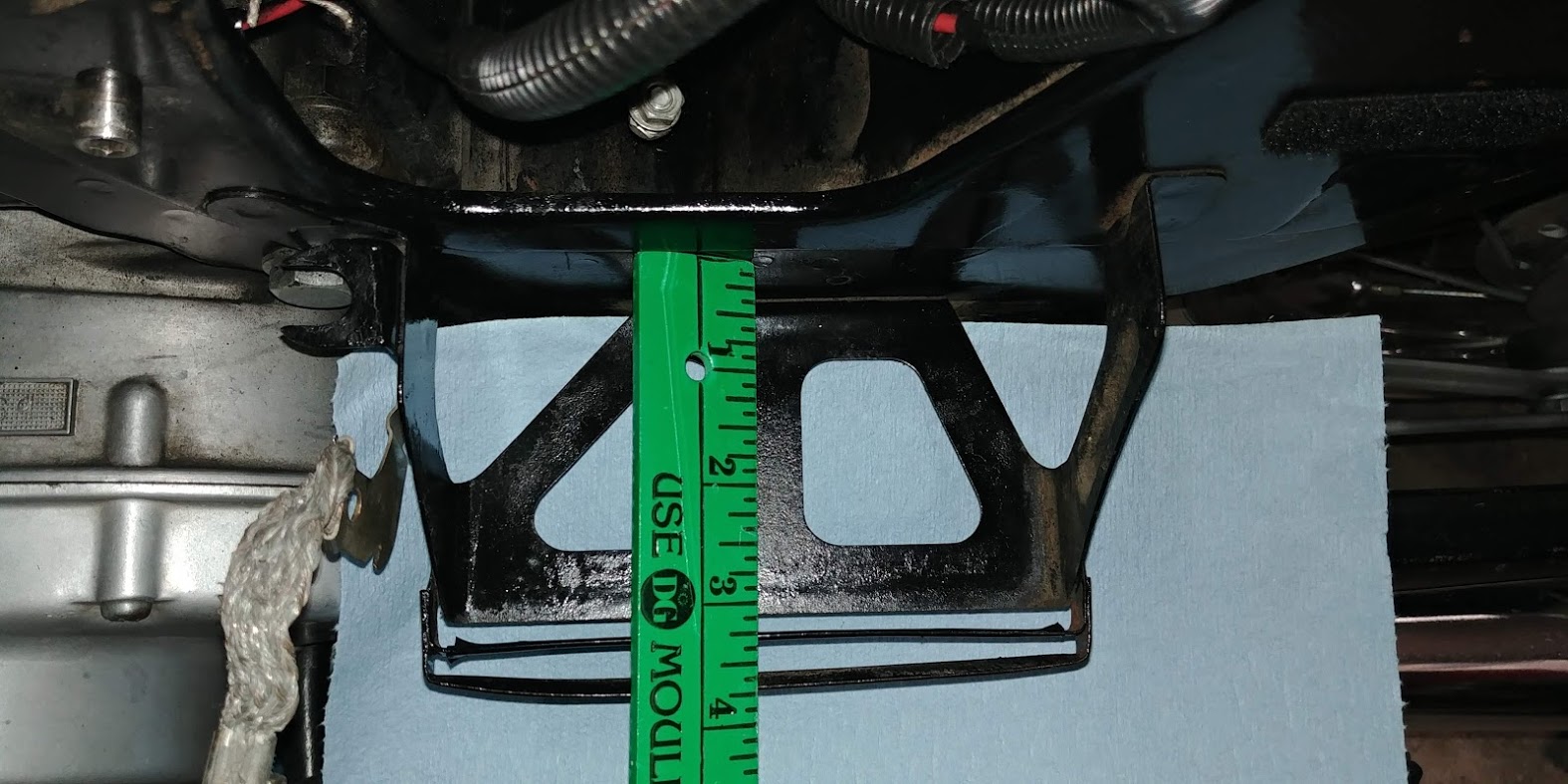

Post by brewsky » Wed Nov 27, 2019 7:44 pm
here's my battery holder...
battery holder.jpg (176.81 KiB) Viewed 2638 times

Thanks brewsky I intend removing the battery today and have a good look what could be wrong but your photo helps a lot. Thanks.

Brewsky, I spent a good hour today and still the same. My battery tray measured the same as yours 3.5" so that must be right but the cover only measures 3" so that's where the difference is and why it won't fit up to the framework.

Post by brewsky » Fri Nov 29, 2019 6:19 am
Cas
The measurements are a little deceiving from the camera angle......the tray itself is only 3", the additional slot dimensions are 3 1/4" and 3 1/2" out.
After looking more closely at mine, it too sits away from the frame a little bit, maybe 1/4", at the bottom, so maybe just the angle of the bottom tab on the cover makes the difference.
battery holder.jpg (83.92 KiB) Viewed 2625 times
