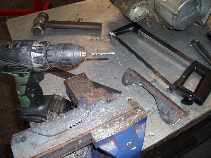

Thanks, I cut a couple of lengths of 2 inch angle, marked out with the profile copied from the frame, and cut/chain drilled the shape. Blended the corners, removing all burrs and drilling to suit the bolts.
Some fettling to get the correct fit. All in all the sort of thing to get this project off to a good start.

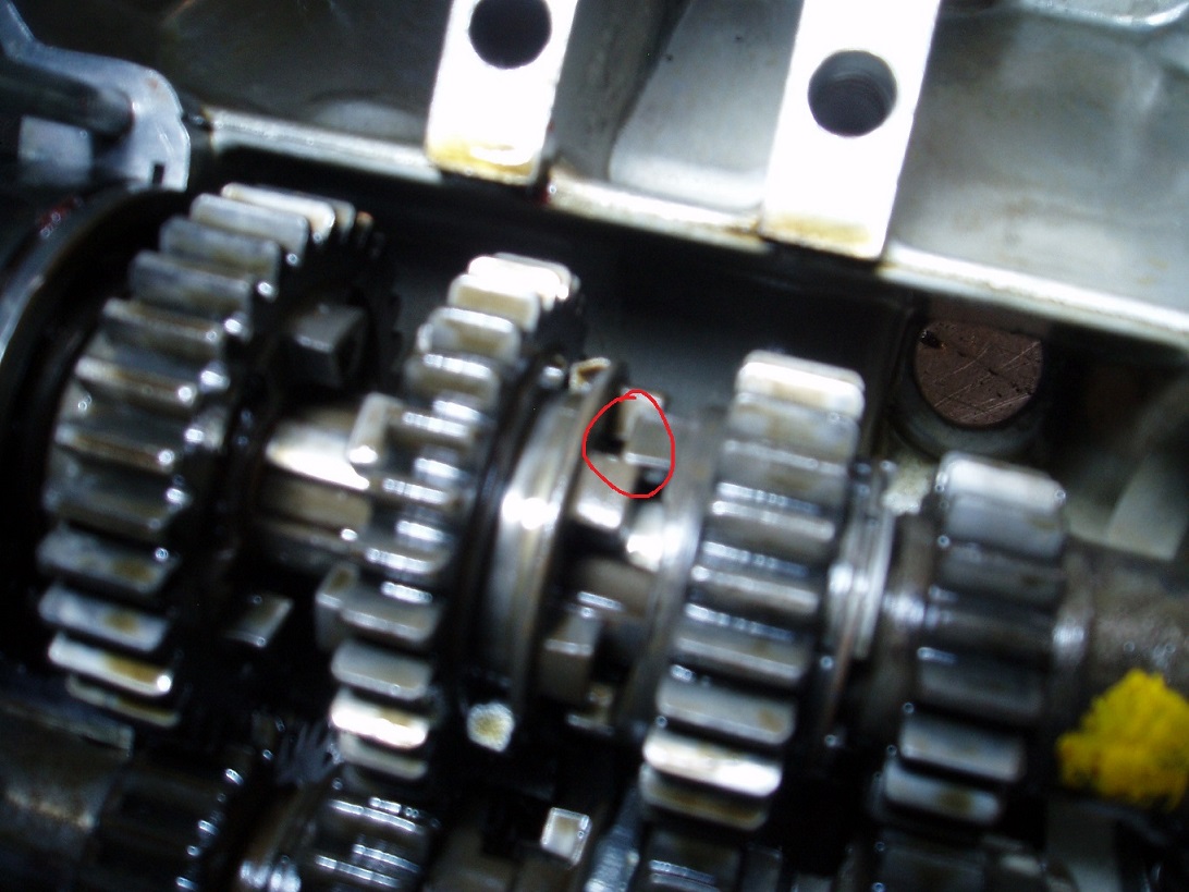

Here is a better, but not focused, picture of second gear in maximum engagement. Not a lot compared to 1st and 4th which have full engagement.
Am I correct in assuming that by fitting the appropriate offset cotter (I haven't seen one yet) that the engagement on the gears for each pair would just be 'evened up', as the shaft gives a fixed movement due to the grooves? So 4th would lose and 2nd would gain.
Also I measured the endfloat on the selector shaft and selector forks and got around 1.25mm, most of which is play between the selector pin and the shaft groove. The shaft I can shim out, but the rest?

Adesky
If you look to the right of your red highlight, on the other side of the gear is a wire circlip. This locates the two cotters, which are either flat, or staggered (offset). They locate in a groove on the shaft and locate the gear. Not sure that you will get a massive amount of extra engagement but the taper on the dogs will pull the gears together when you put torque on.
Part #14 is the cotters.....
http://www.cmsnl.com/honda-cb77-general ... ml#results
As for endfloat on the shafts, you should be able to shim them but the clearance may be due to worn bushes.

Thanks G and Chase, I have now seen the light....
I noticed that the engagement problem also afflicted 3rd, but not as much. I will investigate further.

Now would be a good time to cross 2nd and 3rd gears. ....lm
