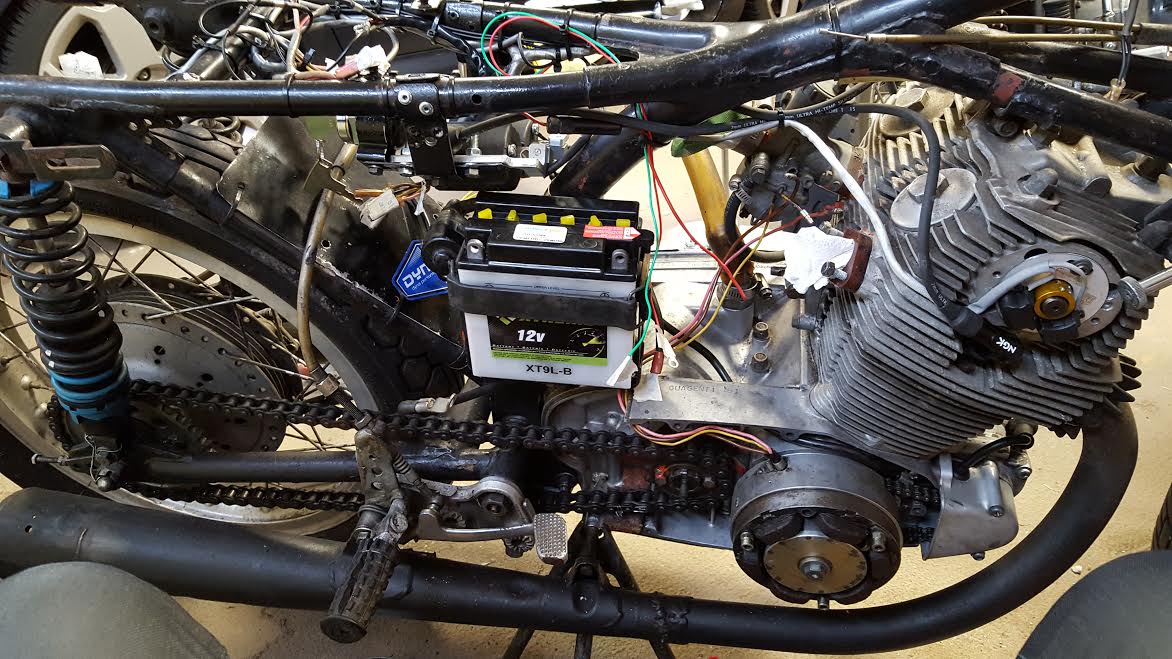

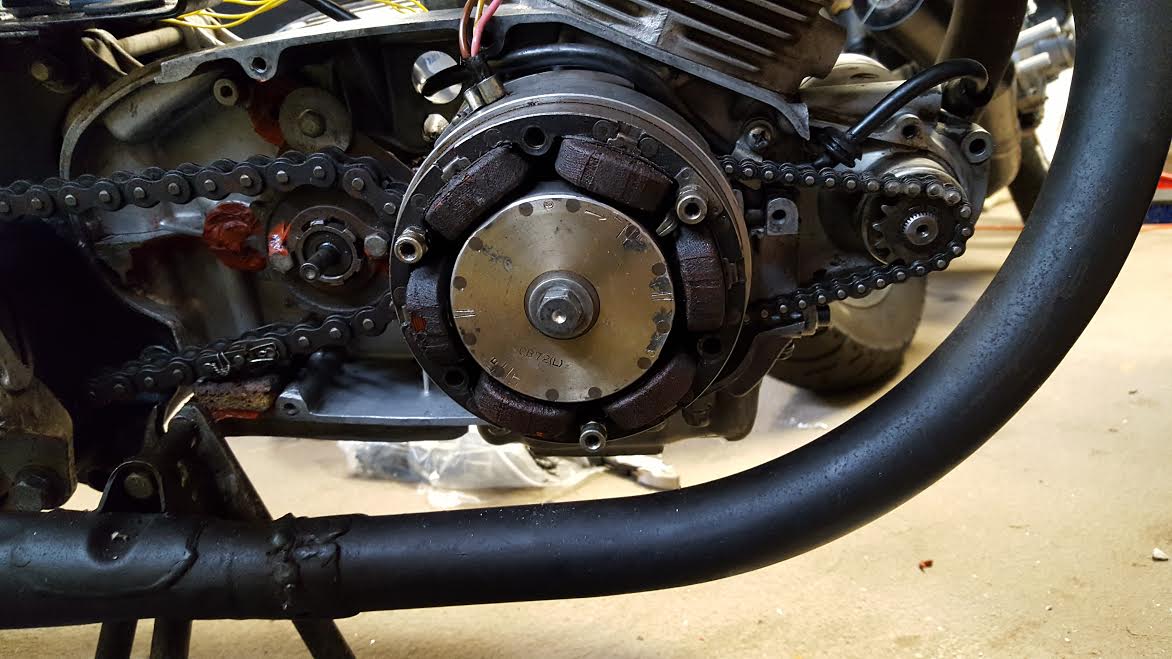

Post by RCP_Espresso » Sun Dec 04, 2016 3:12 pm
Some more progress today.
I got the starter shimmed out so that the chain has a reasonable amount of slack, I loctite-ed and installed the bolt on the sprocket retainer, and I got the rotor (with new clutch hardware) installed on the crank with the woodruff key. It was a little challenging to get it on even knowing the trick, but it only took a few tries and then a few taps with a rubber mallet.
Some of the resin/glue on the coils of the stator is cracked, and it allows the coils to slightly wiggle. Should I use some sort of glue to secure the coils? you can see the cracks in two of them in the picture.
I also got a battery and had to slightly adjust the coil location on the right side to factor in the height of the battery. Only a little wiring left and then a bit more cable management.
Next step will be to drain the oil and pull the oil pump for inspection and upgrade. I have a cappelini 6mm oil pump gear set coming sometime this week.
Sometime in january I should have the duplex primary chain setup coming from england and I'll be able to get working on the left side of the bike.
For purposes of completeness and documentation, I'm going to get the bike titled. I have enough random lights and horns that I shouldn't have a problem getting it to pass an inspection... doesn't have to be too pretty as it will be coming off right after I get the title. I'm looking at getting with MCRA to get my racing license and start doing track days hopefully by late spring. Luckily there's a few tracks around Indianapolis as well as the corvette track in Bowling Green, KY that I can easily get to... now to get a trailer hitch and a motorcycle trailer.

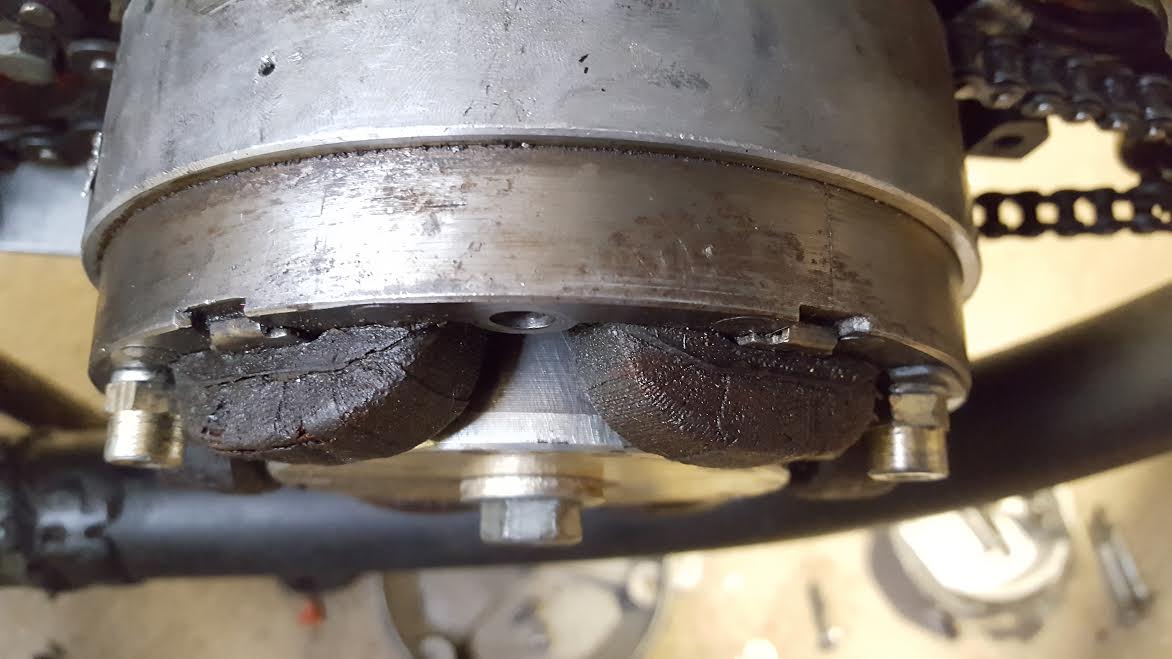

So I got started on the oil pump today.
Drained the oil and pulled the pump and found this guy hanging out next to the screen:
Seems to be two bits of a chewed up washer. I'm going to get an extendable magnet and fish around up in the sump for anything else. I'm not alarmed yet, but if I find more I might be.
I shot an email to cappelini/valtermoto asking about these two items.
The first is a washer. There are two of these. One of them (like I found on the original pump) was placed between the large gear and the housing. I'm not sure where this guy goes. There's a smaller washer that is for the other side of the housing where the shaft retaining bolt goes.
The second unknown right now is this large hex bolt. It fits into threads in the new housing, but doesn't pass through into the old housing. There is an additional allen bolt that does pass through to the old housing. My guess might be that this bolt is meant to sit up against the filter screen housing, but I'm stopping work until I can find the right answer.
I also got the first carb assembled and tore down the second carb for a berrys dip bath. The current jetting in it (from presumably the last time it was run) is a 38 low 145 high.

Post by G-Man » Wed Dec 14, 2016 4:47 pm
Providing the existing pump housing is not scored around the periphery or the face and you have new gears you should be fine.
I was going to mention the hex bolt for parting the cases but you got there......
