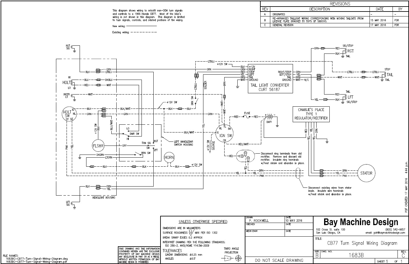

Seadog,
Revised wiring diagram below. Some of your comments made me realize that more information on the diagram would help me avoid confusion and possibly mistakes as I do the actual wiring. The ignition and headlight switches now show all terminals.
The changes to the stator, headlight switch, and old rectifier terminal wiring result from conversations with Charlie. 3-wire harness from Charlie's reg/rect is not needed - the wires are long enough to go all the way to the stator connections.
The Honda wiring diagram shows a 5-terminal headlight switch. My switch has only 4 terminals. If you look carefully at the diagram, you'll see that the HL and ML terminals are wired together, rendering the switch effectively a 4-terminal device.
Interesting terminology on the Honda wiring diagram:
The blue headlight wire, which is the high beam wire, is labeled "Dimmer." Seems like a
strange and misleading translation.
The red headlight wire, which is the low beam wire, is labeled "Main." I guess if you do
your night riding mostly in the city, you'll be using mostly the low beam, so maybe calling
it "Main" is understandable, but still - maybe not the greatest translation.
Fun fact: the battery is labeled "Buttery."
Hoping to finish the wiring today and light it up.
Phil

Excellent job on the new diagram, Phil. Very easy to understand. I'm sure future readers will appreciate your time & effort; I certainly do.

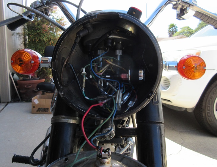

Post by philrock » Sat May 21, 2016 1:26 pm

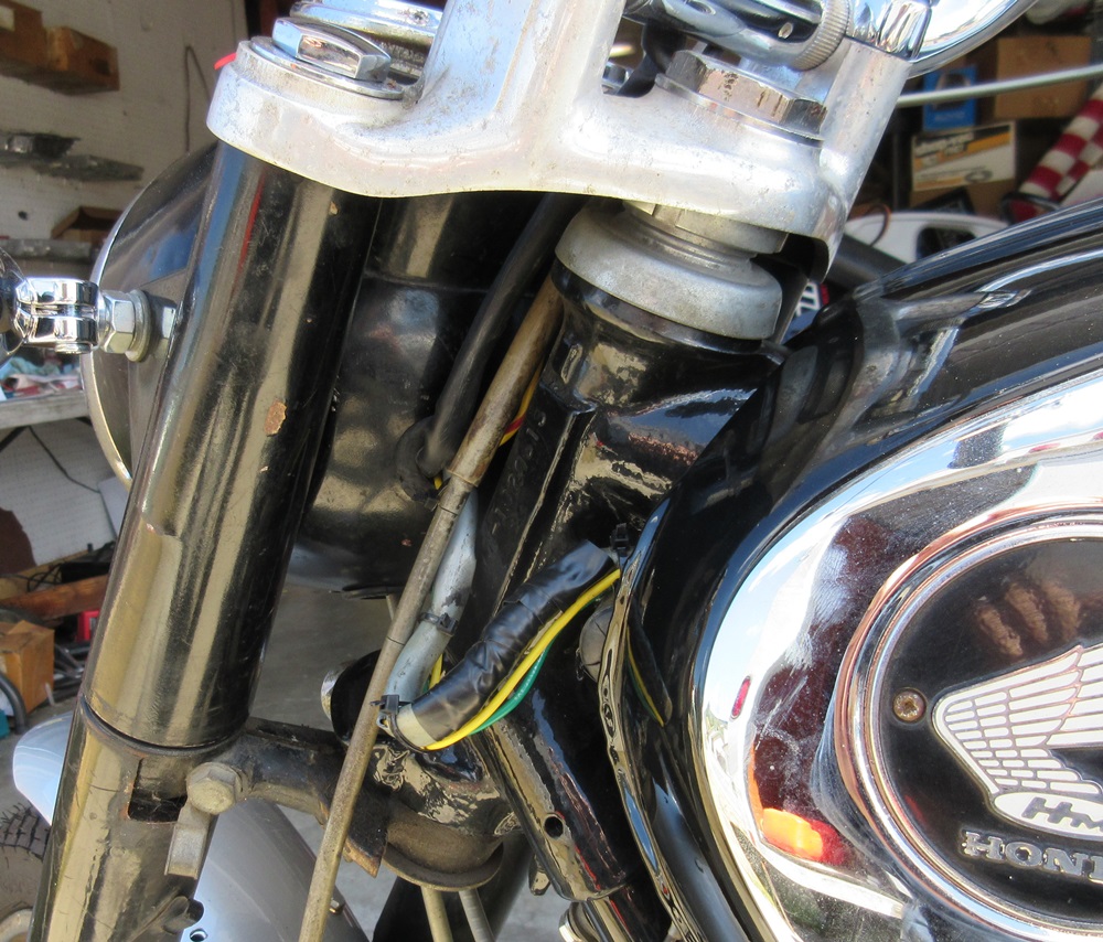

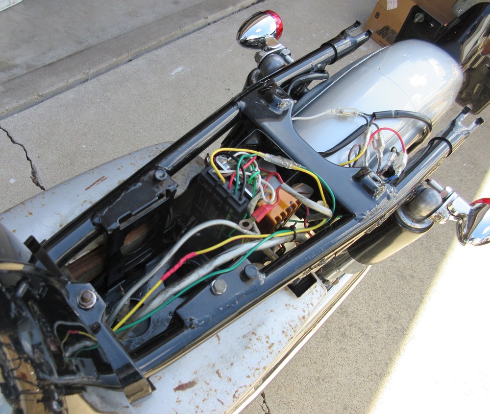

The turn signal project is done. Photos below. All lighting works as intended, except for an annoying delay (2 or 3 seconds) when you first turn on a turn signal. The delay must be due to the bimetallic strip in the flasher warming up. I could probably improve this by adding dummy loads (resistors) in parallel with the lamp filaments. Battery is dead, so I had to improvise to do testing. Note that battery is missing from the underseat wiring photo. Still need to check charging current and voltage, which I can't do until I get a new battery.
I'll tie off the underseat wiring at final assembly.
Only had to add 2 wires to the harness.
Headlight bucket wiring got very busy.
Still have a lot of paint and plating work yet to do.
Phil

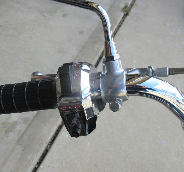

Well done, Phil! The bike is looking great. I also like your turn/horn/headlight switch; what is it from?

Here's the turn signal handlebar switch:
http://www.ebay.com/sch/i.html?&_from=R ... 1670098969
The polishing under the chrome is poor quality - consistent with the price, and the wiring diagram that came with it has a couple of wires swapped.
The polishing on the turn signals is excellent. I bought them from Charlie's Place, and they are made by K & S Technologies. K & S also makes turn signal switches:
http://www.kandstech.com/index.php?page ... scontrols#
There's a chrome one toward the bottom of the page. I would bet the quality is excellent, and the price a lot more than I paid.
