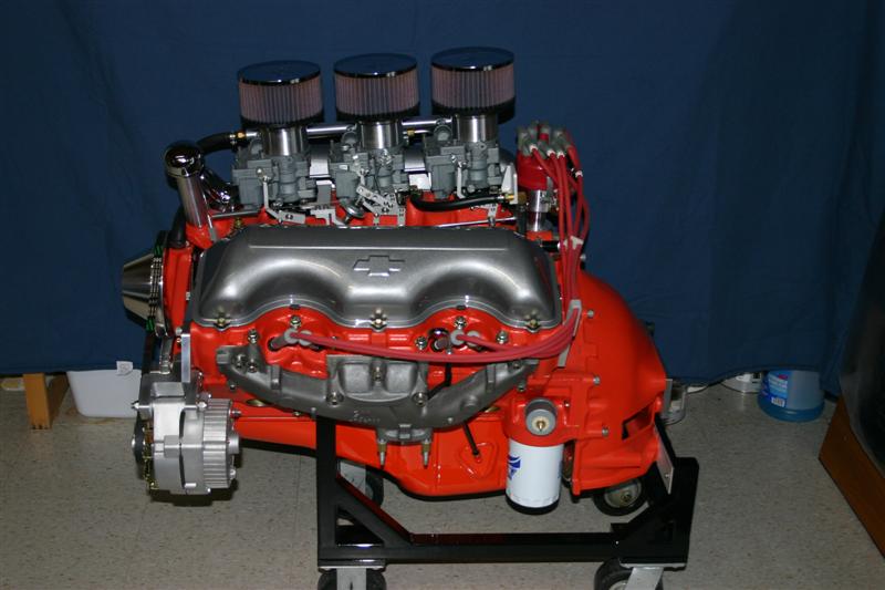

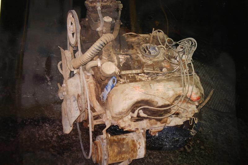

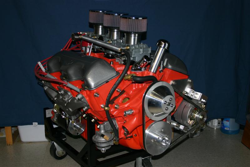

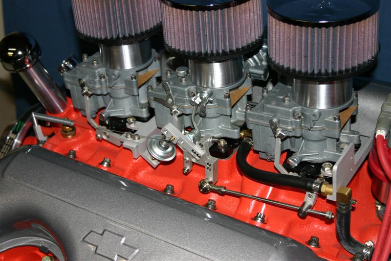

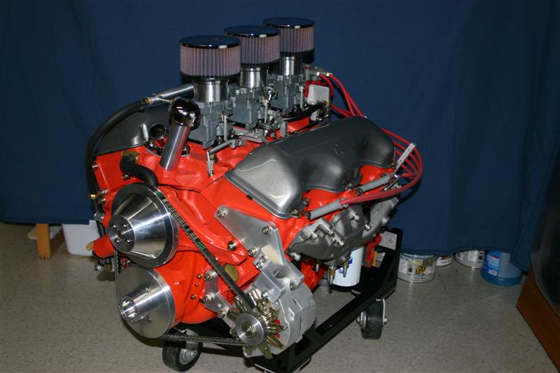

A couple of pics of my 1961 Chevy 348 [first big block], starting with a "before" pic. I had a '61 Impala SS in '68, with the 3x2 set-up - always liked that engine.
