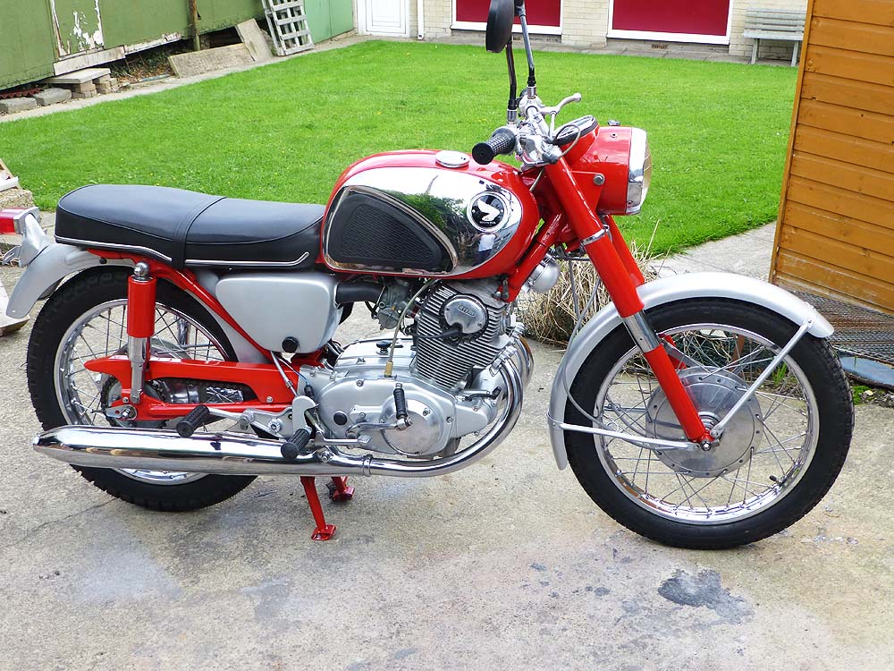

Modelman, from the photos your mudguard looks just like a Honda CB72/77 one ! e-bay look out. Excellent work. Tell me please does the grey thing in the corner of the garage have anything to do with it ?

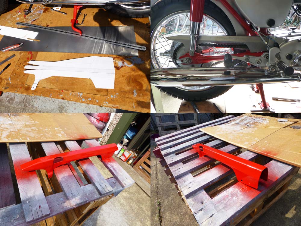

Managed to buy a small amount of 1 mm steel sheet from a local garage yesterday, made a card template & 'guesstimated' the shape from photos, snipped it out, bent it up, a little bit of welding, hammering filing & priming etc. Just about to spray it when my compressor decided to blow up & spread itself all over the workshop!!
Had to get out the backup rattle-can to paint it, I'll remove it & do it properly once I've repaired/renewed the compressor.
I don't think its a million miles away in the looks department.

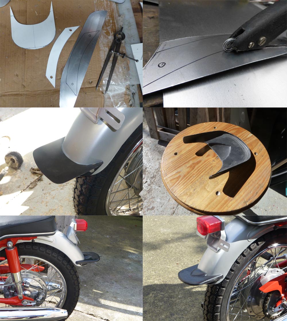

Change of plan, I was going to have a go at rubber-casting the tail-piece, but several items needed buying to get it all going, so I decided to 'have a go' using junk I had laying about in the man-cave!
A sheet steel support was cut out & fabricated from the chain-guard off cuts, painted up & bolted to the rear fender.
Carved the tail from wood offcuts, then thermo-formed the part from scrap ABS sheet, not too sure about the textured finish though, don't look too bad from about 20 feet away however!!
