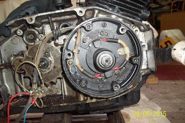

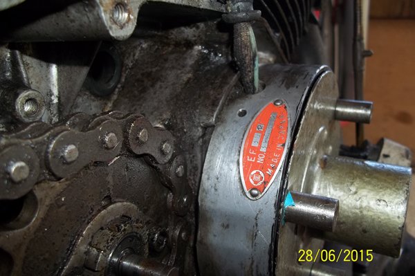

Started the strip down. Has anyone come across the electronic ignition I have here before?
Could do with knowing a little about it and some info in the set up before I go to far.
There is no generator that I can make out, so would this be a total loss system? I am not that clever with the electrical side of things!!
Thanks Dave.
Make of Electronic ignition.
Internals of Electronic ignition

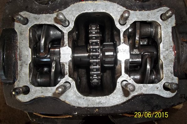

Random pic of the cams.

Is there a electronic box that goes with the ignition? Under the tank, maybe? There might be some clues there.

G-Man wrote:Dave
Hi G
Yes there is. I didn't take a pic of that. It is a piranha ignition EF3U 3L0372. I will take a pic and post it.
