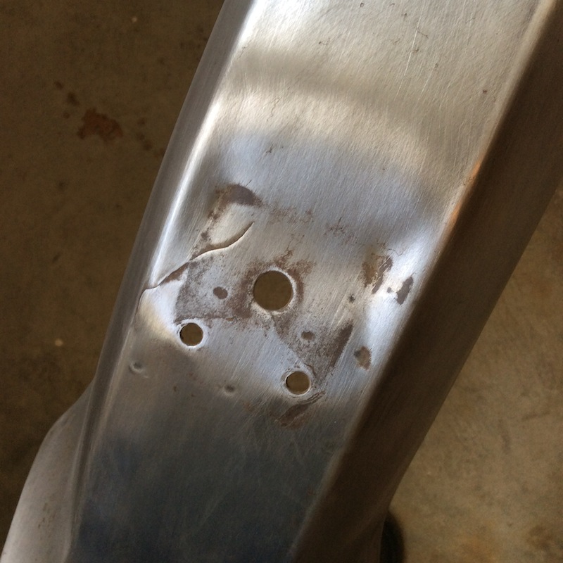

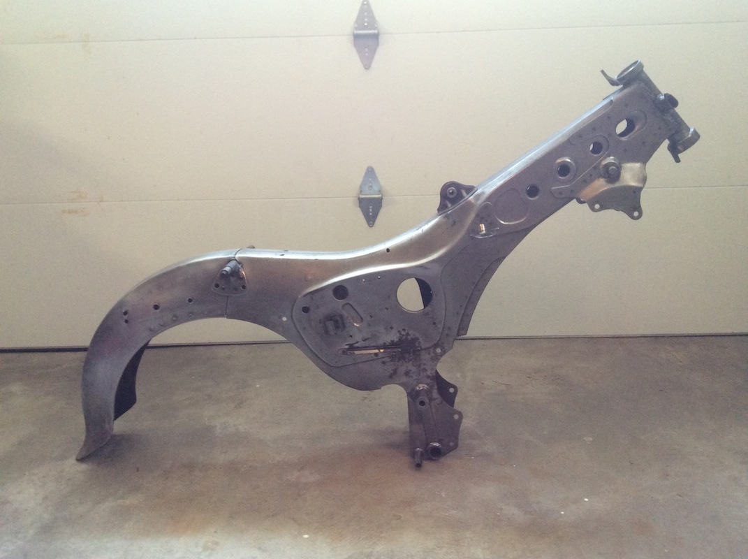

Worked on stripping the paint from the frame for the past couple of days. Finally finished the outside today. Lots of grinding to do though and the back fender is bent and cracked under the license plate frame. No other bad dents, but lots of rust in the side cover areas - especially the battery side. I really want the frame stripped, repaired and painted in advance of receiving my wheels.

Seadog wrote:Worked on stripping the paint from the frame for the past couple of days. Finally finished the outside today. Lots of grinding to do though and the back fender is bent and cracked under the license plate frame. No other bad dents, but lots of rust in the side cover areas - especially the battery side. I really want the frame stripped, repaired and painted in advance of receiving my wheels.
After stripping my frame I found those same license plate section cracks, and my rear fender was also totally separated up both sides near the shock mounts, probably from someone sitting too far back on the bench seat and going over a rough bump. Thankfully it was still attached across the top and a little welding and grinding smoothed out all the issues for me.

deafanddiabetic wrote: After stripping my frame I found those same license plate section cracks, and my rear fender was also totally separated up both sides near the shock mounts, probably from someone sitting too far back on the bench seat and going over a rough bump. Thankfully it was still attached across the top and a little welding and grinding smoothed out all the issues for me.
I've spend days going from one auto body shop to another, trying to get the body work done. I found that not many were interested in the work, although they've all been intrigued by the bike. Yesterday I found two places that will do the work, but want to have it media blasted before they'll take it. None of them have the capability of blasting something as large as the frame.
I've spent even more time trying to find a media blaster to do that work. I finally found one and delivered it today. 1 hour away from my home each way. They don't do round frame bikes, but, again, they were intrigued by the sheet metal frame and agreed to do it and the swing arm for $100. I left it there and hope they get to it soon. It will have to be primed immediately. As an aside, the owner told me he had a 1974 CB360 that had been sitting in his garage since 1975. He had no plan to ever ride it again. Unfortunately, he said he'd stored some pool chemicals on top of it and it was pretty rusty. Very sad.
