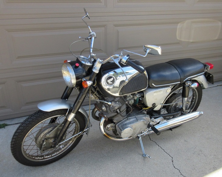

Got the bike together and running. Many misadventures along the way, including broken piston rings, broken piston skirts, broken timing chain idler wheel, etc., etc.
New charging system from Charlie's Place, and turn signals (which I'll remove for an upcoming show).
Photo below.
