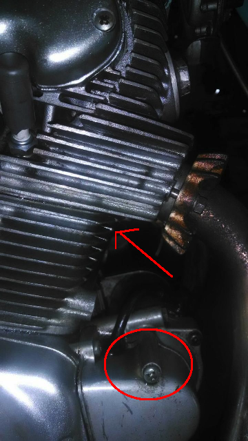

I now installed the head gasket, knock pins, o-rings and put the "open" gasket on top of the head, followed by the metal breather shield, finally the rubber gasket that looks exactly like the breather shield, with the two holes/ports in both of those gaskets towards the exhaust of the engine.
My head nuts torqued much better this time, I got them to 24lbs/in and tightened the nuts below the spark plugs to quite firm, but not stupid and break them firm. Next, I made sure the exhaust and intake valves were at .01mm, they hadn't moved a bit since removing the head.
I let it sit overnight and retorqued the head nuts to 24 again, some had fallen a point or two.
So, upon running the bike the left side front of the head gasket does NOT leak anymore, but the front right does. I can even watch small bubbles appear while shining a light at the gasket while it's idling. It idles beautifully at about 900, but it still leaks.
I did a compression test again, the non-leaking side has 90, the leaking right side has 125.

Just a guess but it may be what another member of this forum had.
The knock pin is to tall/long. ..........lm
