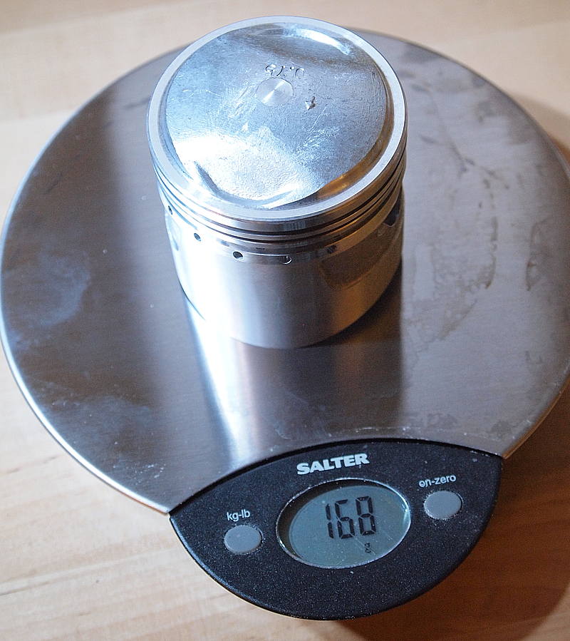

Standard CA72 pistons start at 54mm and then go up in sizes in 0.25mm increments. You need to either measure the pistons accurately or clean the tops gently and look for markings. Often the "oversize" will be marked. i.e. +0.25, +0.50 etc...
See my picture below. You can make out the 0.75 on the crown.
The rings you need will then be decided by the size / markings. Early ring sets had the thicker compression rings, later rings were thinner. You need to look out for CB72 rings with a later revision code to get the thinner rings.

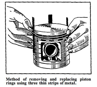

The normal technique is to use three thin strips of metal positioned around the piston and then you can slide the rings down over over the strips.

So, I have the correct rings, the 268 part #. Measuring the rings and the booklet specs they seem like they should work. I got the oil rings on just fine (thanks for the metal strip method, it's PERFECT), but the middle black rings don't seem to fit down into the grooves on either piston. I remember when I took them out the first time that these specific rings were very tight in there too and didn't seem to expand or slide around (that's why I assumed they were stuck rings), and I know the top is the silver edged ring and it fits just fine in the top groove.
