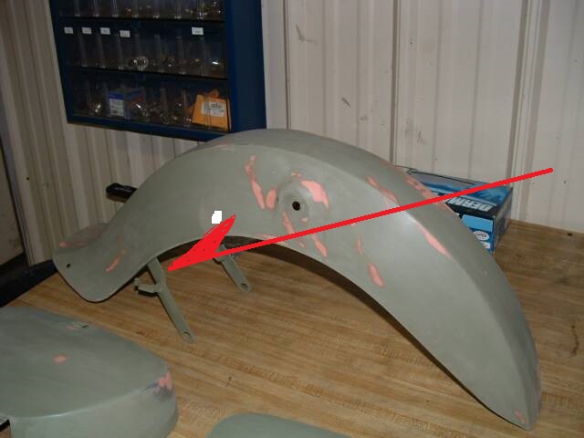

Post by brewsky » Fri Mar 21, 2014 7:05 am
It goes under a small screw-held clip on the fender strut, behind the chrome fork brace.
I can get a better pic later today.

[quote="brewsky"]It goes under a small screw-held clip on the fender strut, behind the chrome fork brace.
I can get a better pic later today.[/quote]
Excellent! Thank you VERY much. I just found the part number for that clip on CMSNL & found one on eBay. It's on the way.

Post by brewsky » Fri Mar 21, 2014 9:07 pm
No problem!
You may need to loosen the axle and rotate the speedo drive some to get a smooth curve in the cable after clamping it under the clip.
