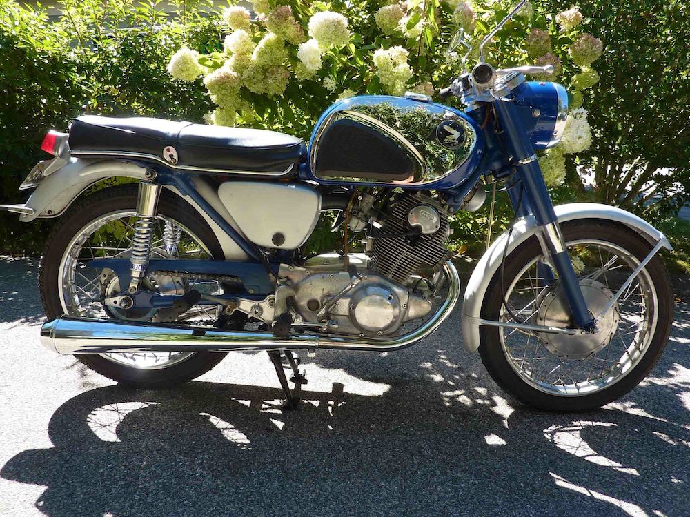

Finished my restoration...
Post by jmn » Wed Oct 15, 2014 12:20 am
Hi - I thought I'd show my bike after a year of restoration. I now ride to work (approx 25 mi. each way) when the weather is decent. Runs pretty well with the occasional shift not getting into 3rd gear, but it usually gets there...i spent a lot of time with a steel brush on a 2 wheel buffer, and most of the metal and chrome parts came back to life. Had the tank side panels and brake arms on the wheels rechromed. Had the tank and headlight shell professional painted, and spent many hours degreasing the engine and replacing the gaskets, among other things...Couldn't salvage the mufflers or shocks, so I went with Hagon shocks, Emgo Dunstall mufflers (loud!).
Two tips I thought someone might find helpful:
I needed to replace my chrome fork seals. The originals where very rusty. But removing them involved first removing the lower brass bushings, which are riveted in place. I tried to punch them out, but they wouldn't budge. So I ended up drilling them out, tapping the hole, and using set screws (#10-24 x1/4" from Bolt Depot) which I filed down so they conformed to the curve of the bushings (inside and outside) and used Blue Threadlocker to hold them in place.
Original gas cap was leaking - cork was not in good shape. I ordered a new cap from Classic Cycle Parts with a rubber gasket. It has more clearance from the top of the tank than the original cap, which was good - easier to get on and off. It came with a rubber gasket - seemed tight, but still leaked when the tank was 3/4 full.
Thought I'd try cork again - seemed like it might seal better. So I found some cork/rubber 1/8" sheet at Autozone - part #3019. Traced the rubber gasket, cut it out, and it works great - no more leaks!
This forum was invaluable!
Jon
