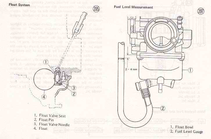

Well I hope it sinks for ya. OK on the new inlet needle and seat - you do have the aluminum crush washer in there right? You are right to check the floats hanging up on the gaskets. Those gaskets both aftermarket and OEM tend to shrink a little. You can carefully stretch them out before you clamp them in and also pinch in the floats in a little if you have to. You can measure the fuel level in the bowl using the bowl drain, a home-made fitting and some clear tubing (see pic below). Kind of academic though, if it's seeping out at the gasket, it's too high. What else you gonna do though, when the temperature stays in the 30's all the time?

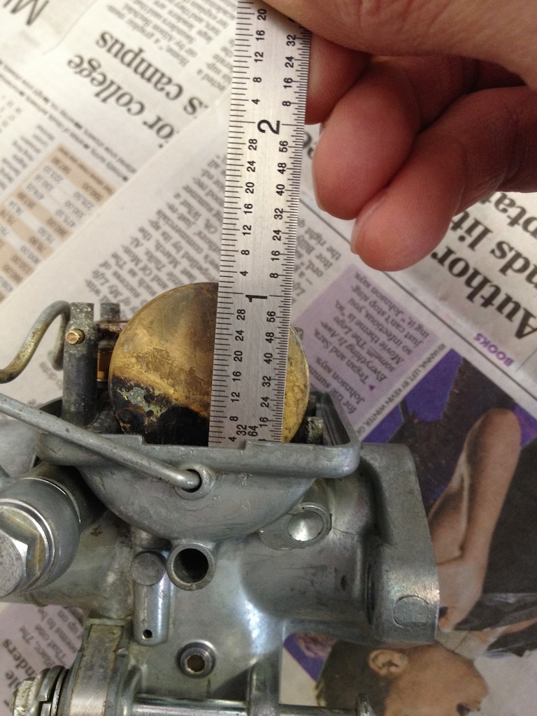

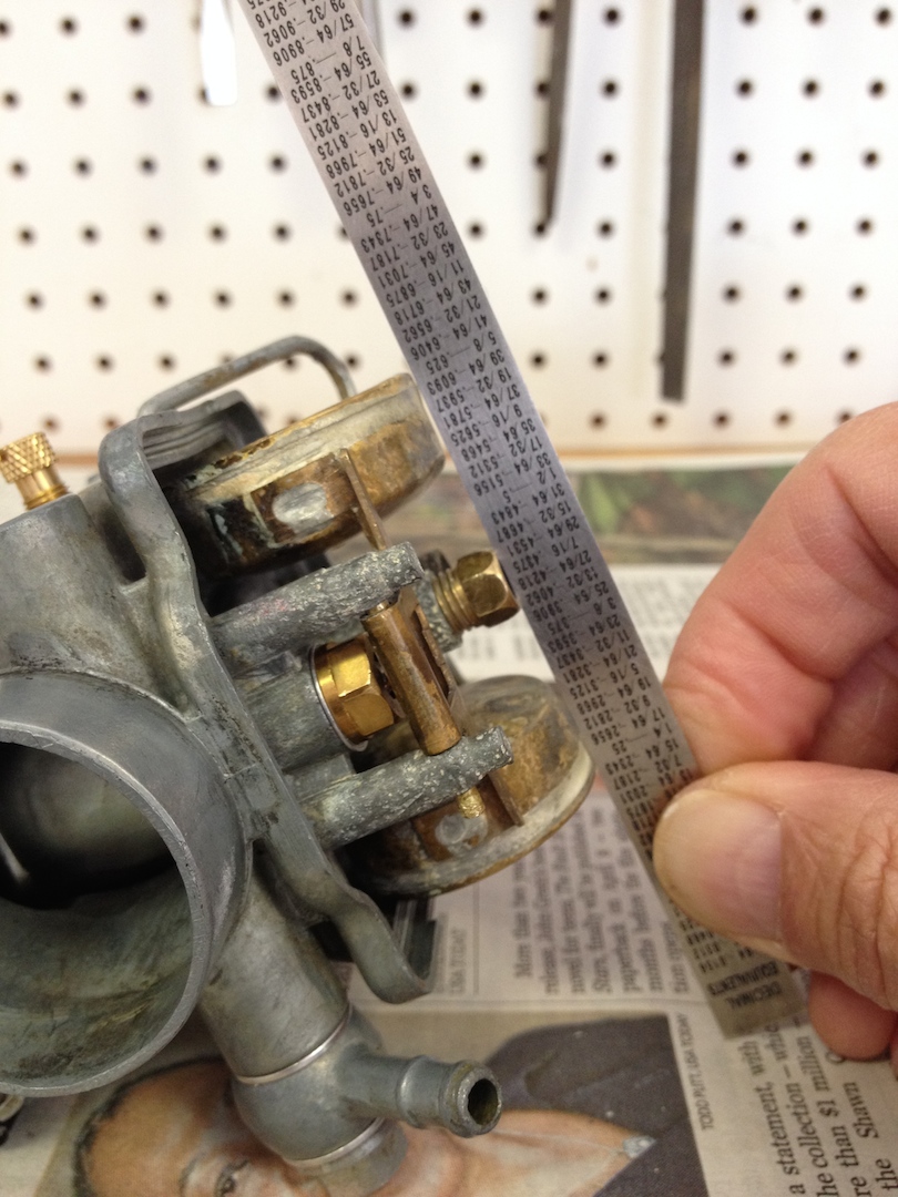

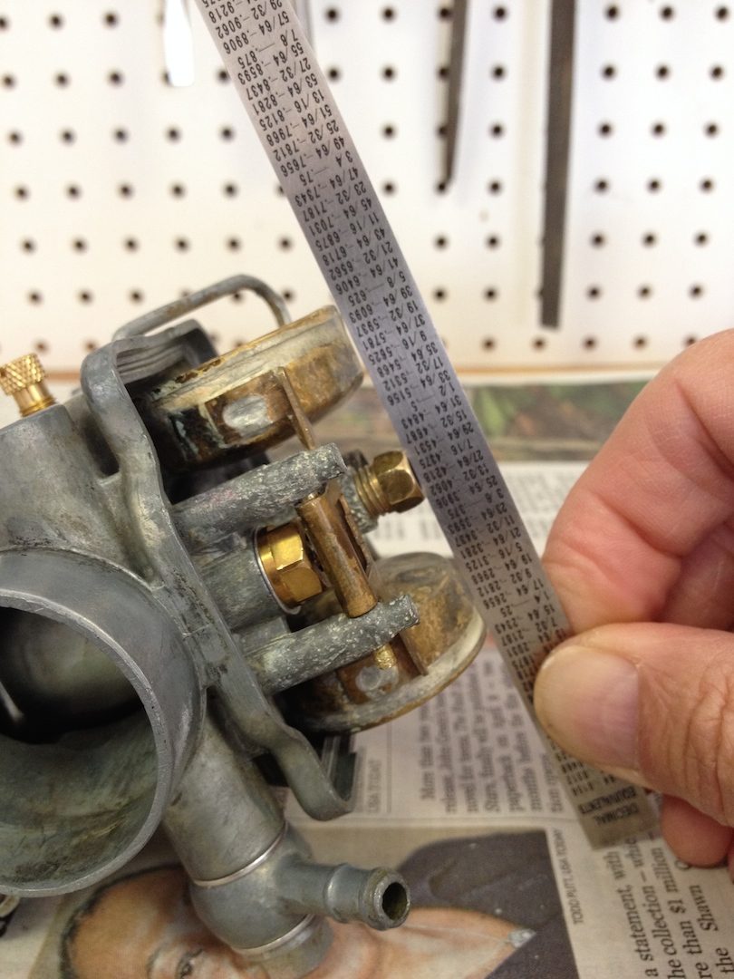

OK where were we? The floats are air tight. Was reluctant to set the float depths to 7/8” (am currently at 1”) because I thought it would only make the leaks worse. So I set a straight edge across the main jet holder and adjusted the floats to just below it - much like the sighting process. This gave me a 1-1/8” measurement which is heresy but I didn’t care. So, with new genuine Honda gaskets I put the bowls on and re-installed the carbs. I also installed inline filters and a quick disconnect on the tank crossover line.
