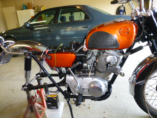

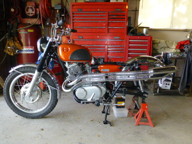

I've gotten way behind on posting! The last 4 months have been crazy. I've retired - the second and last time, at least that's what I tell everyone (last working day was April 6th.) The last month at work was a process of transferring my work load and even some overtime- so nothing got done on the bike. Since then I've painted my house (2 coats, by hand), along with planting a garden and doing all the things I've been putting off to do "when I retire." It finally caught up with me.
But I have made considerable progress in the moments I could steal (to hot or to wet to work outside.) Today was a major plus. I got it started and tuned. Static timing was right on when I used a timing light after, and max advance was on the money. No ride yet, still need tires and a battery. Borrowed the battery out of the CA77 to time and start it.
I was concerned about repainting the tank and side covers, but managed to remove strips someone had put on without major damage to the original paint. The paint color is different where the stripes were, but not enough that I'm going to worry about it. I had a hard time finding the right size and color fuel line locally, but a small equipment shop had it, just had to talk to the right person.
Next step is removing the existing tires and checking and cleaning up the wheel bearings and brakes.
Stock tires were 3.00 x19 in the front and 3.50 x 19 in the rear, right?
Anyone have a line on an AGM battery that will fit? Unfortunately the one from my CA77 is a little too wide.
I think I should have it ready to go for the AMCA National Meet in Davis, CA in June, at least that's my goal.
