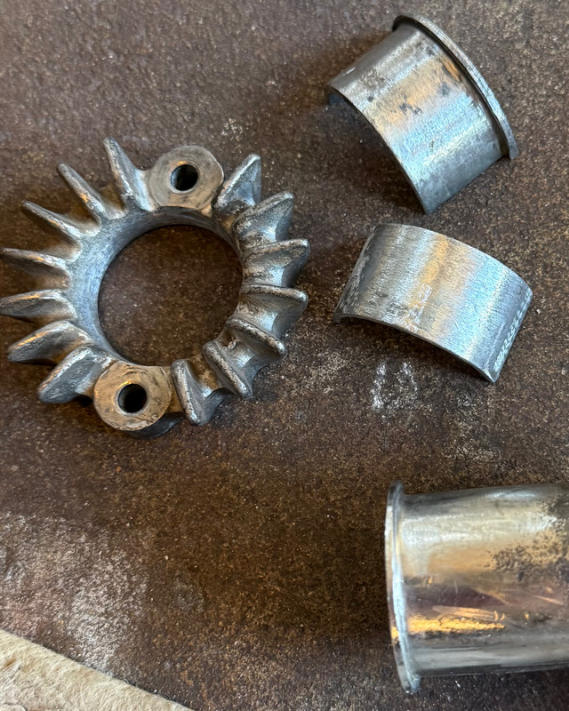

Post by Gene1000 » Fri Apr 10, 2026 3:16 pm
Here’s a photo of the parts I referenced. Nothing seems to fit and I’m not even certain in what order and which direction the flanges go. They also won’t fit inside the collar. Can someone tell me SPECIFICALLY how these are arranged and how to fit them into the exhaust port
Thanks!
Here’s a photo of the parts I referenced. Nothing seems to fit and I’m not even certain in what order and which direction the flanges go. They also won’t fit inside the collar. Can someone tell me SPECIFICALLY how these are arranged and how to fit them into the exhaust port <br />  Thanks!
Thanks!

Post by Muddy » Fri Apr 10, 2026 9:56 pm
G'day Gene1000
I hope this helps.

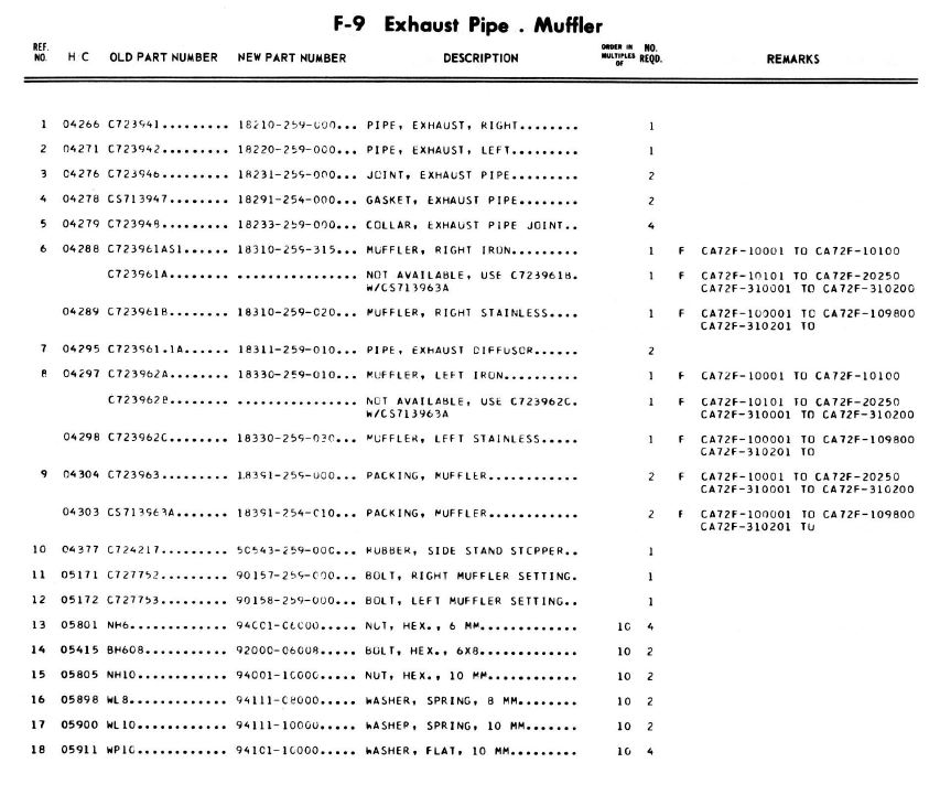

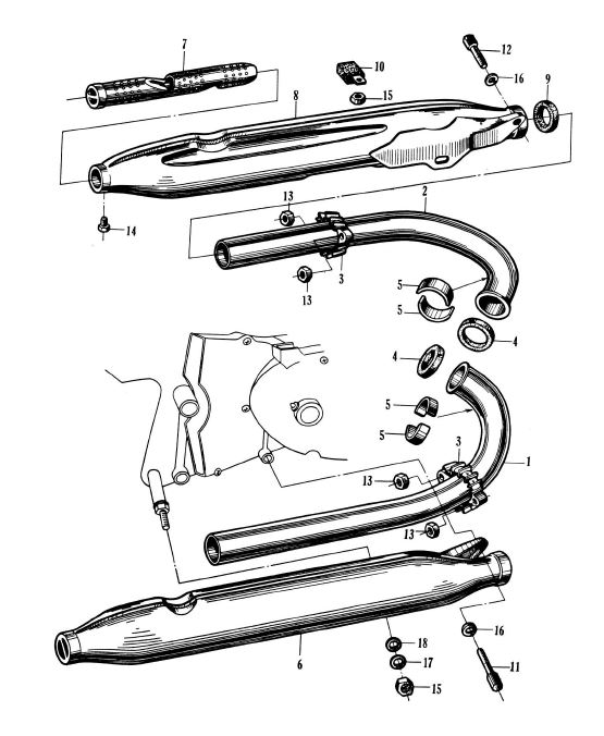

The gasket (Ref. No. 4) fits into the exhaust port on the head.
The joint (Ref. No. 3) [strange name] slides over the outlet end of the exhaust header as shown.
The 2 collars (Ref. No. 5) slip around the exhaust header.
Fit a new gasket into the exhaust port of the head. Insert the header into the exhaust pipe. Slip the split collars around the header at the exhaust port of the head. The larger stepped flanges on the collars go inwards to support the flange on the exhaust header. Slide the joint around the header, up to the collars, pushing the collars into the exhaust port of the head, resulting in the header being retained in the exhaust port. Ensure the bolt holes in the joint slide over exhaust port studs. Secure everything in place with the nuts - I use stainless steel nuts and flat washers - lubricated well with copper-cote or similar.
I seem to recall that one exhaust header is slightly longer than the other, but can't recall which side this goes on. Some research on this forum or the web may reveal the answer.
Good luck.
