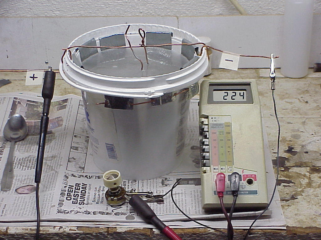

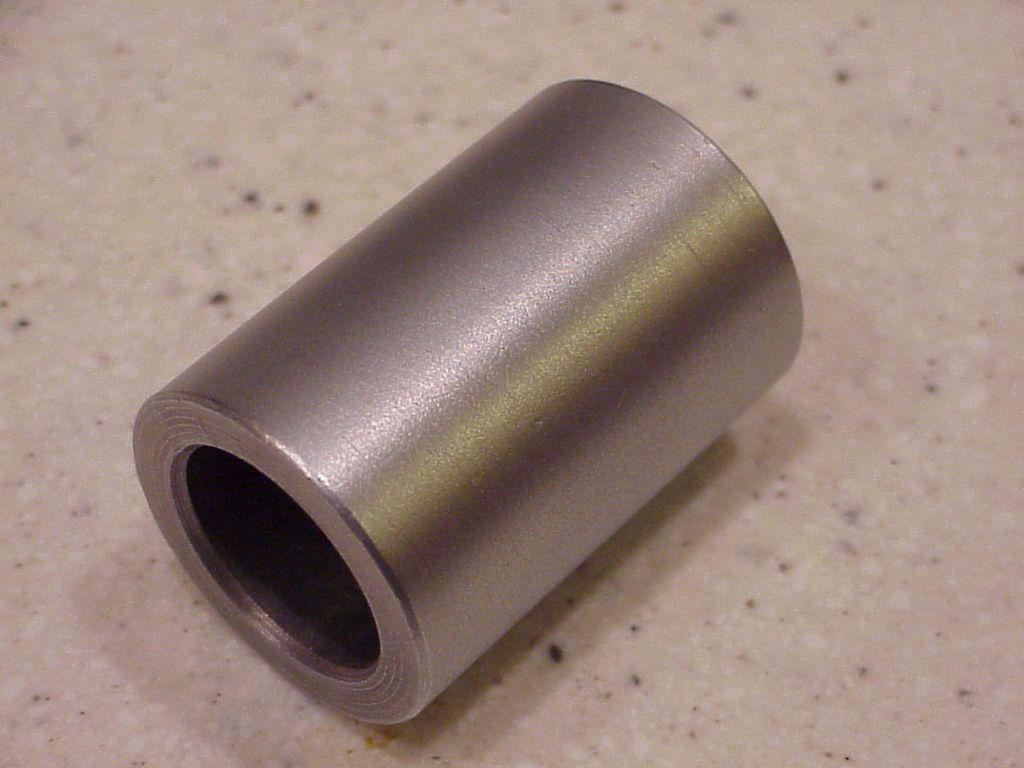

I decided to plate a rear wheel spacer on my CL77 as a test piece. Most of the cadmium was gone. I bead blasted it, then dropped it into phos acid until the rest of the cad was gone. Dunked it in acetone to make sure it was squeaky clean, let it dry and put it in the plater.
The charger I'm using is a 2.9 volt charger from an old Skil Power screwdriver. It is rated at 0.7 watts, which translates to about 240 milliamps max output. When I put the spacer in the bath, and hooked my Fluke up to it, it showed about 300 ma. So I dug thru my junk pile and found a 1K pot and put it in series to control the current down to the 240 ma limit of the charger.
My bath was brand new (and a bit novel so see Bath Mistake below), so no zinc was in solution yet. So it has taken awhile for the spacer to plate. I did pull it out after about 2 hours and gave it a buffing with a Scotchbrite pad. My brass brushes were either shot or greasy. The bath is pretty sticky stuff from all the sugar (again, see Bath Mistake below) so I would suggest scrubbing the part under a hot water faucet flow in the kitchen sink as that will get rid of the sticky bath residue (maybe not necessary if you make the bath right).
By the way, the brushing process or scrubbing with a Scotchbrite is known as carding. It is similar to what you need to do between sessions when bluing carbon steel parts.
So, the spacer went in the bath for another run of about an hour. I pulled it out, carded it under hot running water and it looks terrific. I'm very pleased with how it came out. But it appears that the ID did not plate as it began to flash rust. I could just grease it when I mount it, but instead I made a small cathode to fit inside the ID then submerged in a bath to plate the ID as well. It's cooking as I type this.

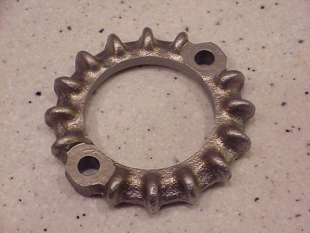

When I pulled the spacer out of the bath, I had one of my cast iron exhaust flanges ready to go. Left it in for about a hour. It will go in for a second coat, but here is a pic after carding. Currently using power supply to plate the ID of the wheel spacer in a smaller, 1 pint tank (butter tub). I also found a good brass brush I forgot I had which is how I carded the exhaust flange.
My tank is a plastic bucket that holds about a gallon. For my zinc cathodes, I cut a 36 inch strip of zinc roof strip in half lengthwise to give me 2 each, 1-1/5 inch strips. I then cut the strips to be the height of the tank sidewalls with some extra to fold over and then connect to a copper conductor. I had enough to make a surrounding wall of zinc. My understanding is electro-plating like this is line of sight. By that I mean the item being plated pulls the ions of metal straight across from the cathode. Surfaces that are perpendicular to the cathode tend not to plate while those parallel plate very well. So, by making a circular cathode, I'm assured of relatively uniform plating. I even made one very long cathode strip that runs down one side, across the bottom and then up the other side to provide a cathode for surfaces facing down in the tank. I made two more strips that were slightly too long and bent them at 90 deg to take up additional area on the bottom of the tank. Total, there are 6 vertical strips running round the outside wall of the tank and the majority of the bottom is also covered.
