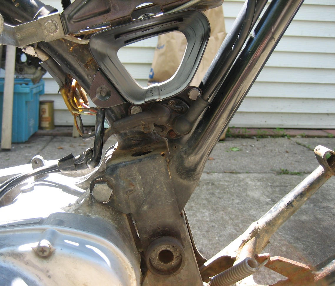

installed the toolbox, starter solenoid and deliberately put the ground cable on the wrong side of the frame.
the positive connector from the fuse could reach the battery, but the ground cable and positive cable from the starter solenoid werent fitting.
i put the ground cable back on the correct side of the frame and it fit.
i replaced the solenoid to battery cable with a spare solenoid to starter cable (much longer), this will get more attention later.

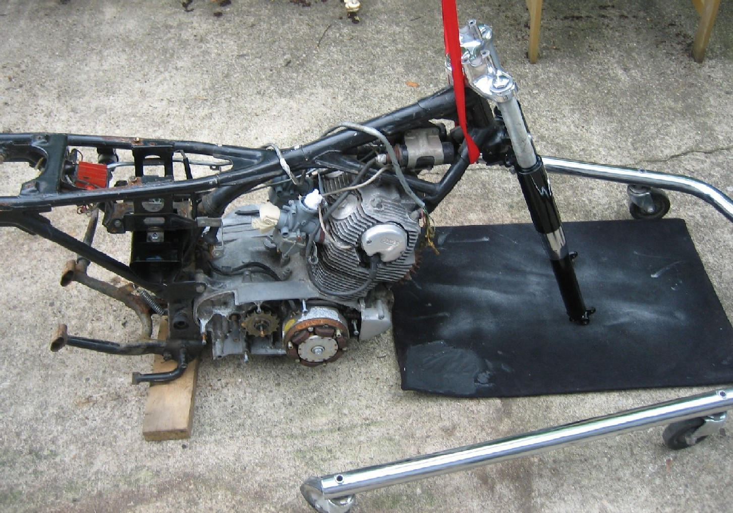

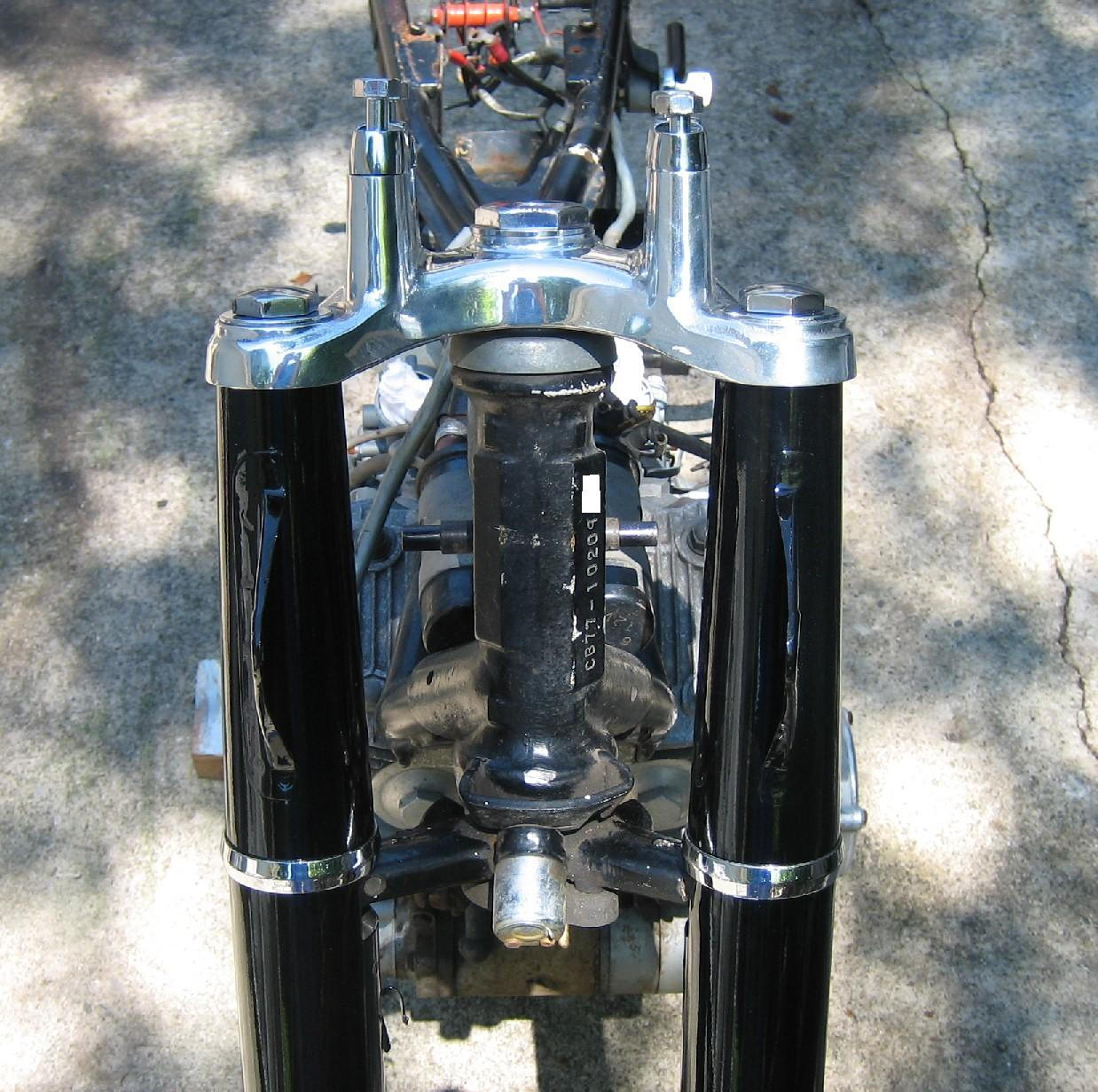

wasnt planning on doing anything with the front end, but the paint on the fork cases was pretty beat.

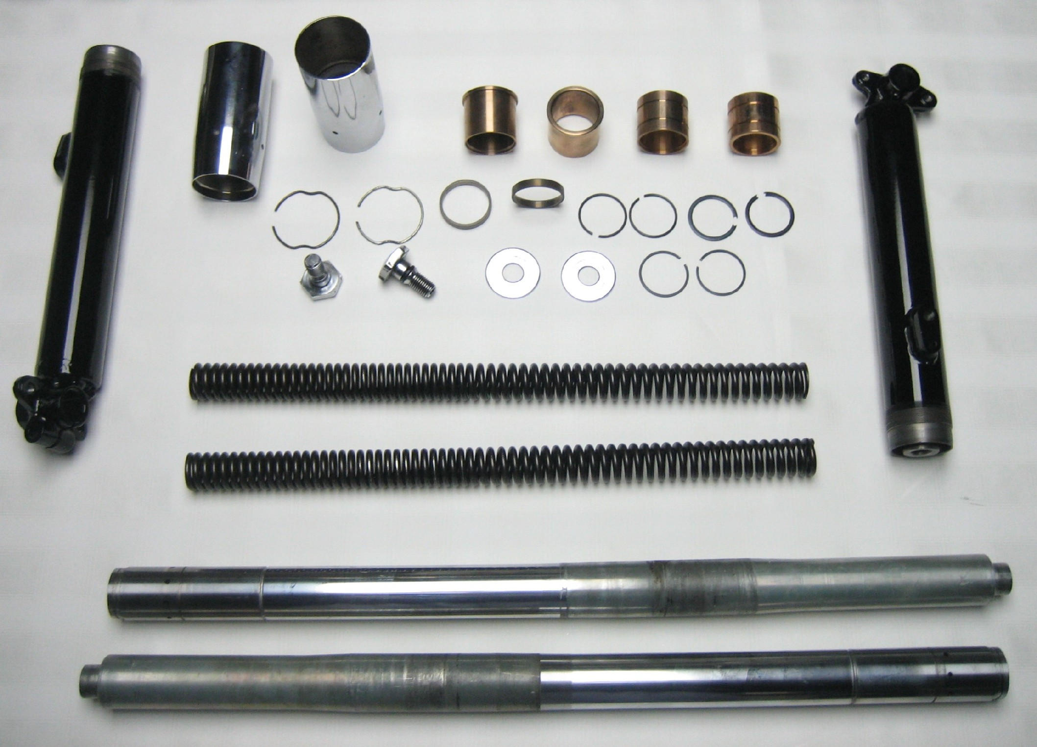

one of the fork seal holders spun off by hand, the other took a lot more effort.
stripped and blasted the lower fork cases (exterior only), rinsed out the inside with lacquer thinner. used tape to cover the opening down to 90% of the threads, then sealed/painted the cases.
the fork seals looked good and werent leaking. i cleaned and polished all of the parts, reassembled and filled with synthetic atf.
fork covers

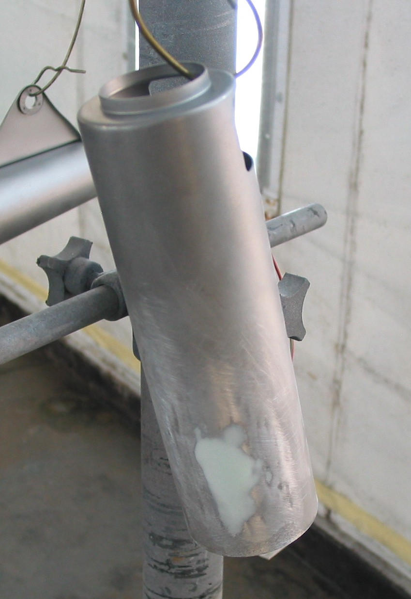

had to do some serious repair to the existing lower fork covers since all of the spares are off alloy forks. removing the dings/dents wasnt a problem, but one cover had a 1/4" by 1" gash.
my cousin came up with the idea of taping the outside of the missing section, filling with epoxy on the inside, removing the tape, and finishing the outside with filler.

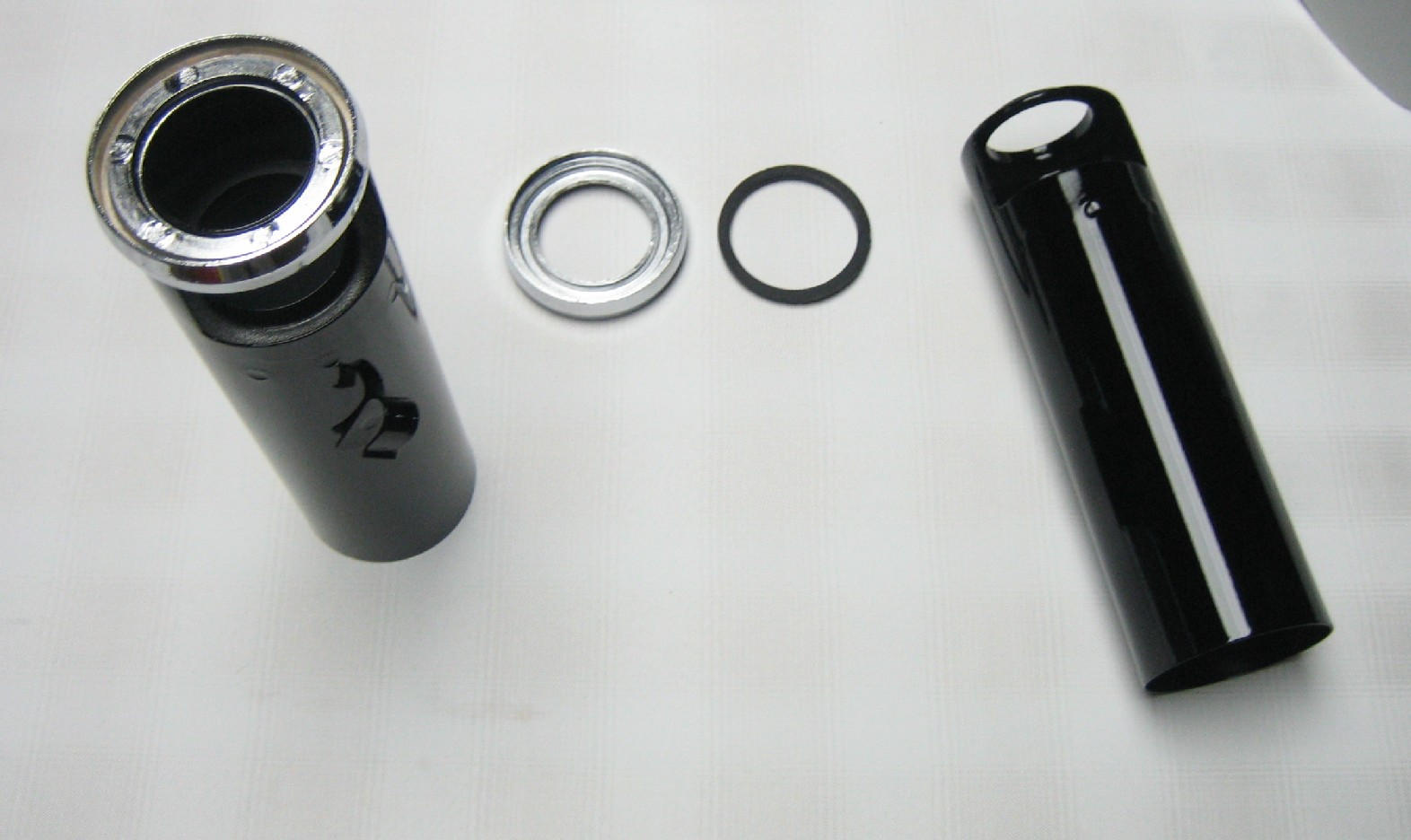

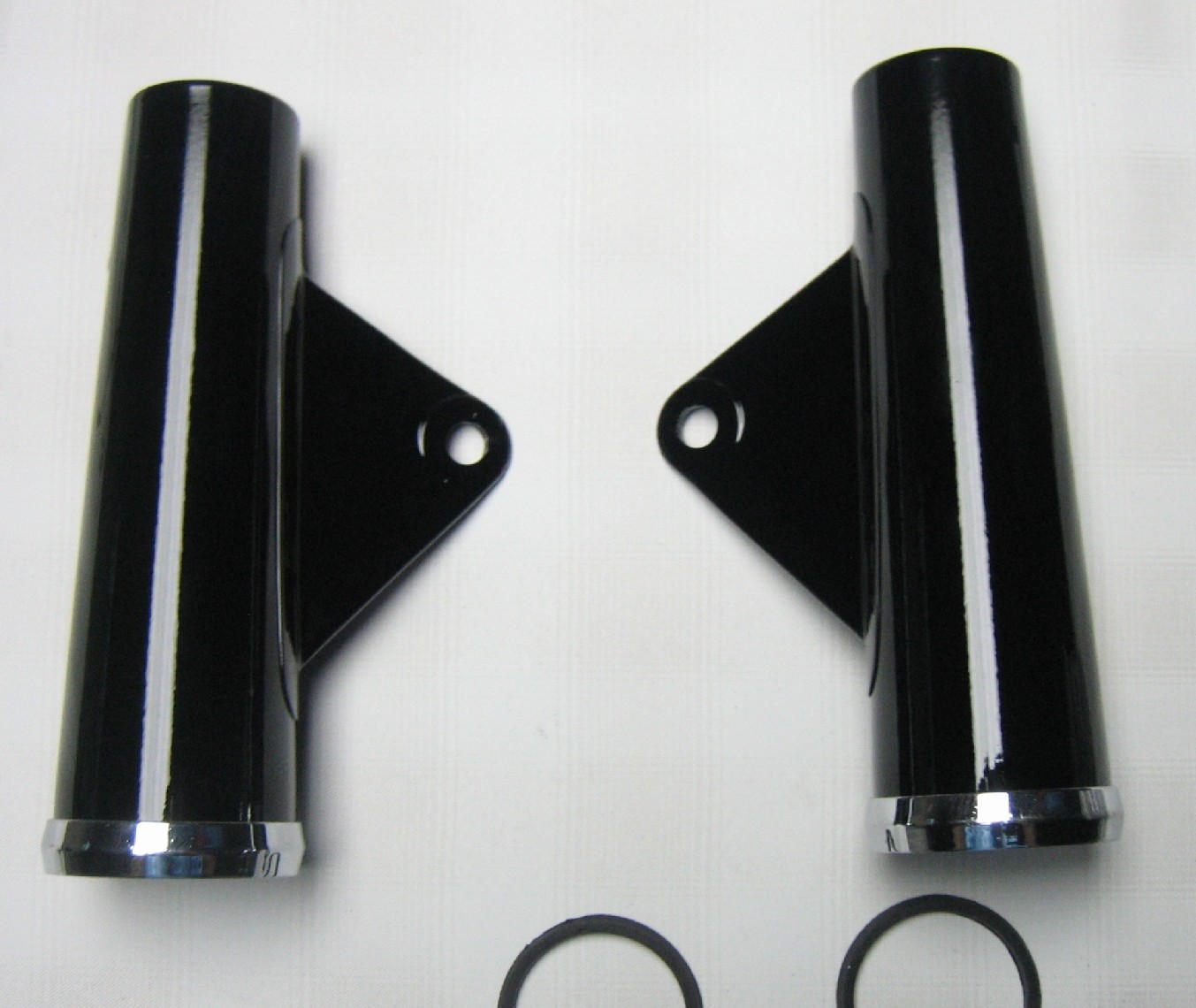

all of the top fork covers are the same (steel vs. alloy forks), so i used the best pair. all the covers were primed/painted.
polished up half a dozen of the chrome fork ribs and picked the least pitted pair...dont forget that o-ring!

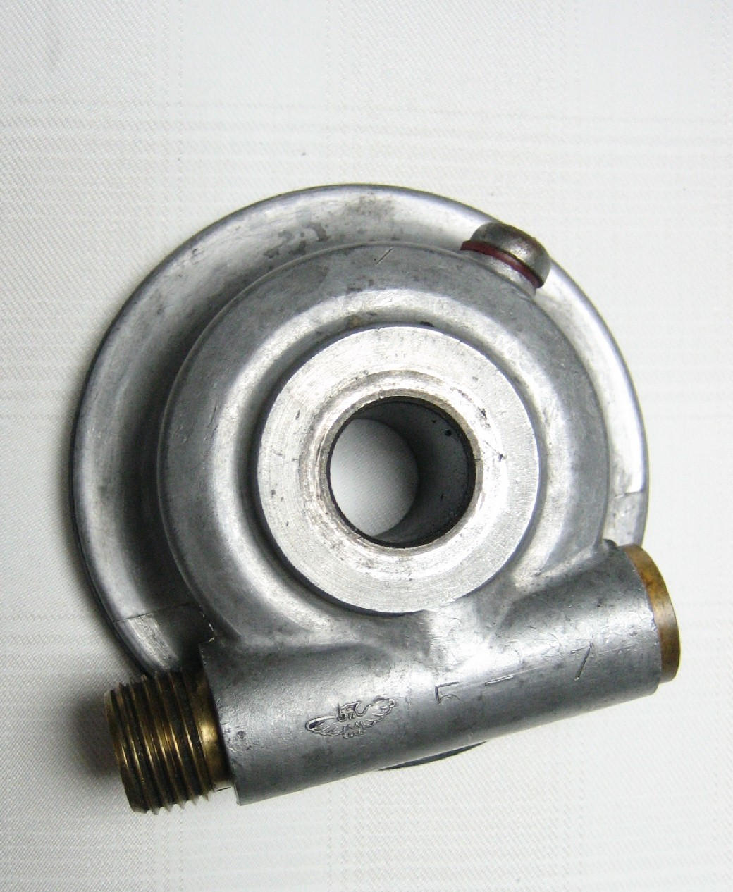

clean the speedometer gearbox (important note for future reference: came with this bike and assumed to be factory original, though the bike had no speedometer)
