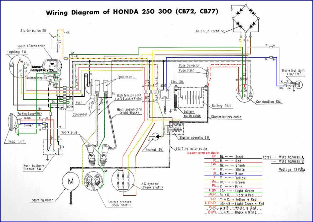

That will be one of the ignition circuits holding 'hysteresis'; the one which has its points open.There is "something" holding a charge in that circuit because when I turn the key off, voltage in that circuit does not go to zero. Instead, it goes down fairly quickly but does not reach zero for several minutes. However, when I move the handlebar blinker switch, it immediately drops to zero.
A solder splice is best, but I prefer to use glue-filled heatshrink to insulate and waterproof. Run one black wire from the keyswitch to the headlamp. Slide about 1.5" of 3mm-1mm heatshrink over this wire, one per drop-off and 'part' the insulation at the relevant drop-off points -- don't cut the wire. Wrap & solder each one and shrink the tubing; a heat gun is best, rather than a flame which will melt the cables' insulation and damage the tubing. Done properly, this method will last forever!
Finally, to make the job like factory, slip about a quarter-inch of white heatshrink (ident) over each end of the main wire before terminating. This guy http://www.vintageconnections.com/ has all the terminating stuff you'll need and is great to deal with.
My 'coloured-in' wiring diagram herewith to help you along. The CL should be identical but without the starter circuits.
