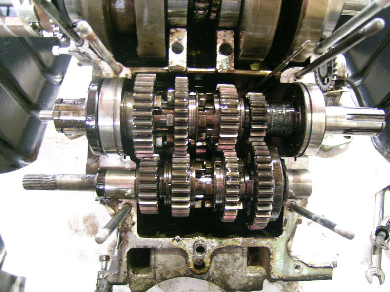

Transmission in its current state.

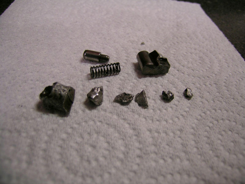

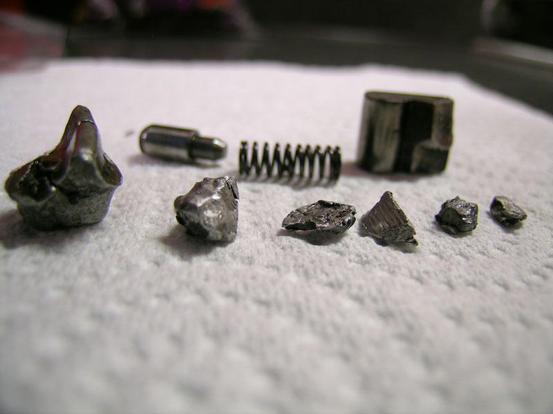

Pawl, pawl spring, pin, and six pieces of aluminum recovered from the crankcase.
Start of a 1963 CB77 rebuild
The PAWL is shot and the spring and tip look OK.
The shaft end needs to be replaced and so does the bolt.
Take a good look at the 14mm brass bushing and send a pic of it also.
I'd almost bet the aluminum is from previous piston breaks. ................lm

Inty wrote:So this is pretty common and nothing to be concerned about?
