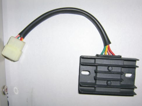

rectifier wiring
ON the bike , at the rectifier you should have red, brn, yellow.
red to red
yellow to yellow
brn to pink
green to ground
Joe
red to red
yellow to yellow
brn to pink
green to ground
Joe
