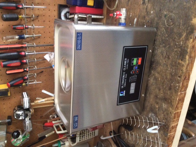

Meanwhile, the new ultrasonic cleaner has arrived, but I'm still waiting for the cleaning fluid to get here.

The ultrasonic cleaning solution concentrate I ordered arrived in today's mail. I immediately mixed a 50:1 concentration and powered up the new cleaner. My first test was my cylinder head cover, which I had previously degreased. One 15 minute heated run at 40MHz, then another at 20MHz. I must say that I was not overly impressed with the results. Yes, it's cleaner, but not as clean as I expected and certainly not as clean as it needs to be. Maybe I'm doing something wrong.
If any of you reading this also use an ultrasonic cleaner, I'd like to know how well you do with it, at what point you discard the cleaning solution and if you filter it to extend its life. Also, do you leave the solution in your unit or remove it after each use?

The jury is still out on the new ultrasonic cleaner. I see no cavitation in the cleaning process and am thinking that the hot soapy water alone is doing the work - such as it is. It makes a satisfying buzzing noise though.... I hope I didn't waste my $ on it.

The results with the US cleaner can be a bit variable. Sometimes the dirt just seems to fall away and sometimes it needs encouragement with wire brush or bead blaster. It's just another one of the many tools at our disposal.
