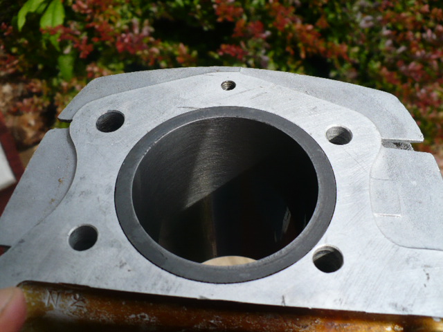

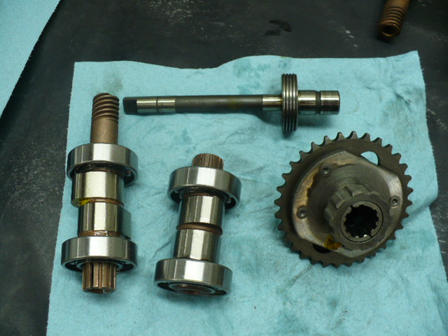

Post by Hoosier Tom » Thu Jun 02, 2011 3:38 pm
OK, got the cylinders back from the bore and hone to S4. This time around I will use NOS cams and cam sprocket. They are the later shallow spline assys, so I dug around to find a points cam assy that had the smaller diam to fit the cam hole.

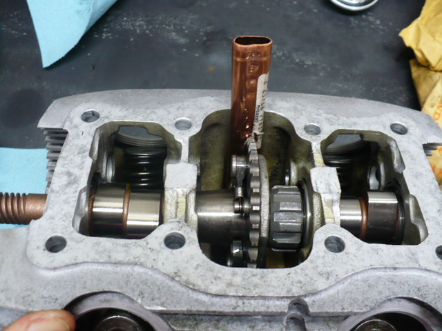

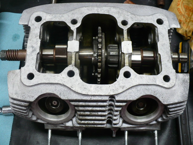

Post by Hoosier Tom » Thu Jun 02, 2011 11:02 pm
Cams are in now. I forgot to note earlier I keep a piece of copper pipe handy to lock the cam sprocket when I tighten or loosen the sprocket nut.
HT

Post by e3steve » Fri Jun 03, 2011 3:27 am
Good call, using the copper pipe to lock the sprocket! Did you smack the nut tight with a blunt chisel? Or did you use the toolkit's pin wrench?
