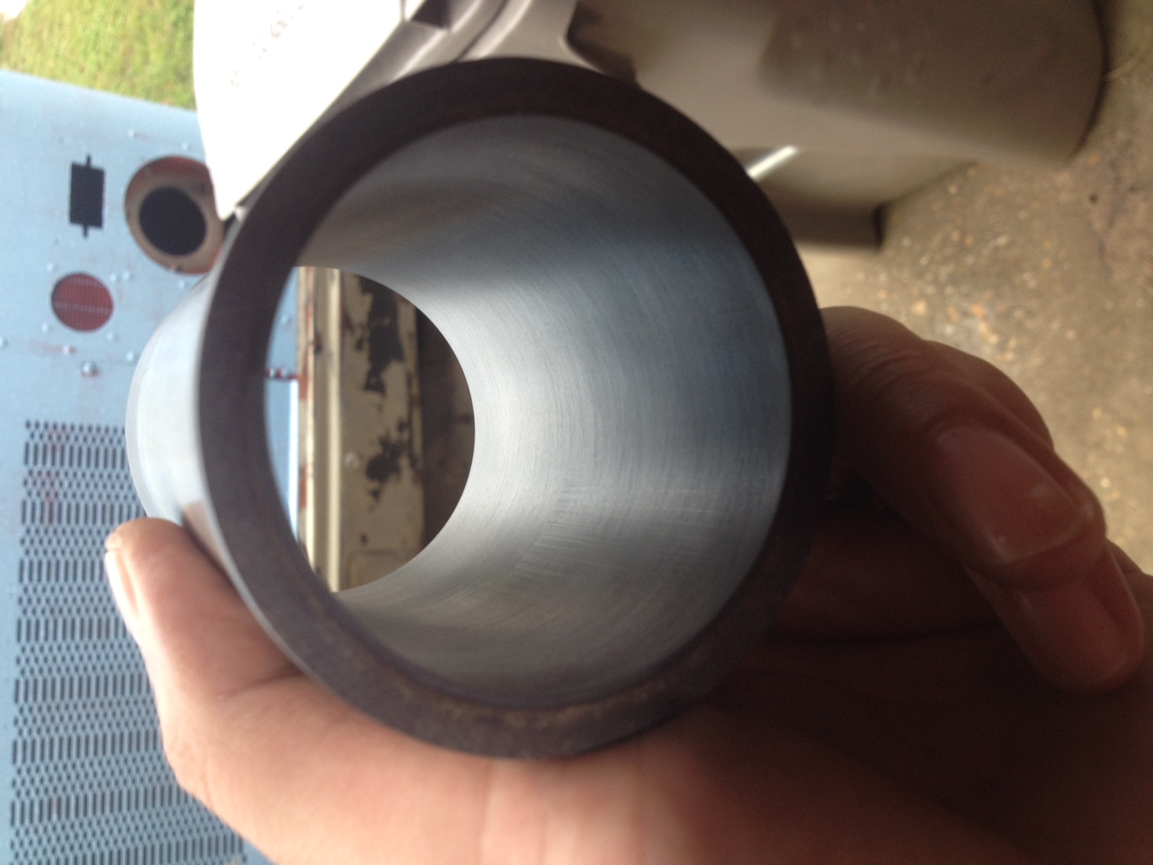

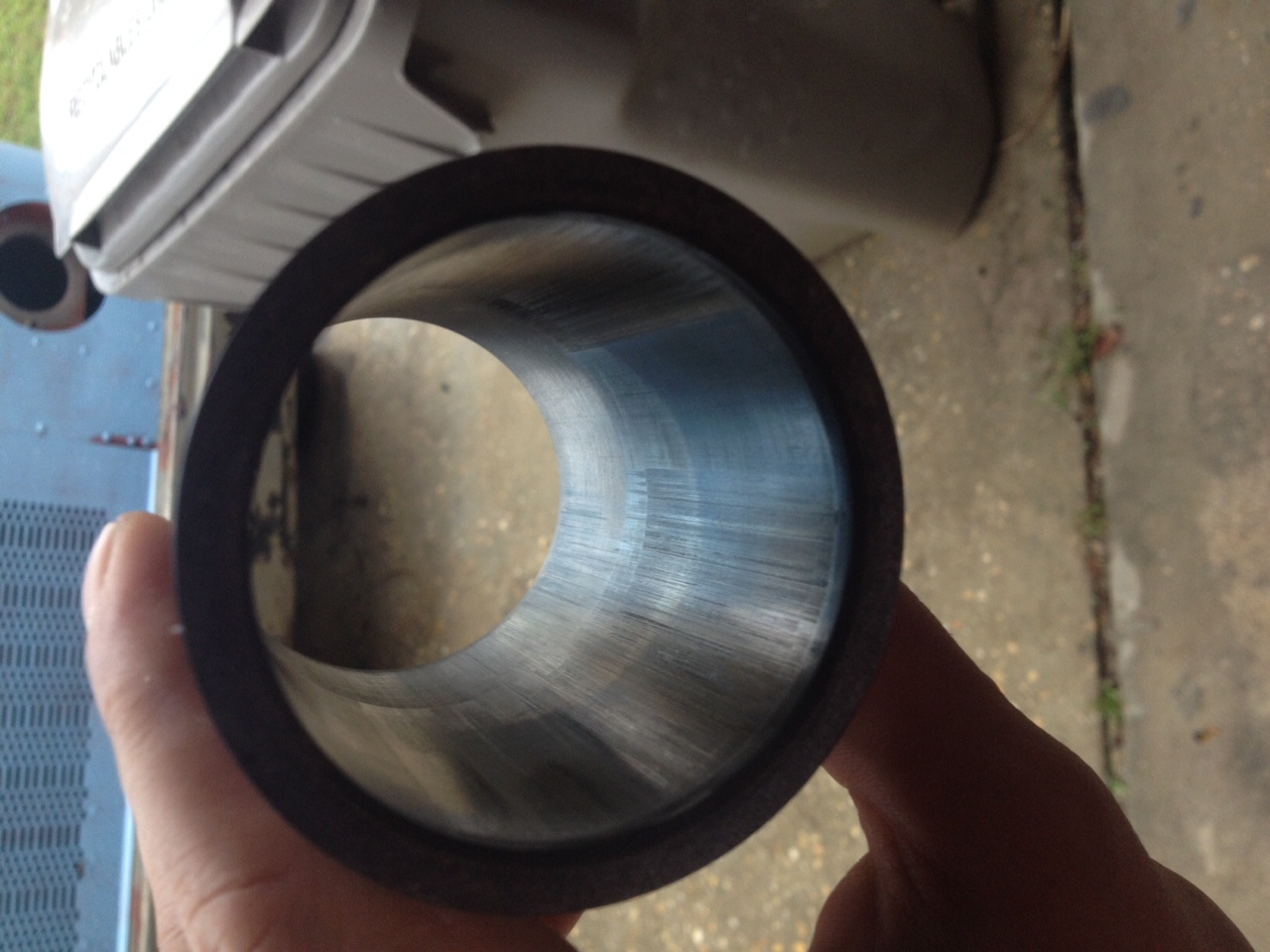

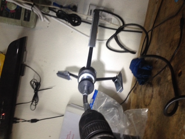

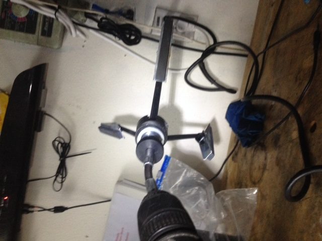

Method: I used a 3 stone flex honing tool with "medium" grit stones on a drill. It took 2 passes, 3-5 seconds each. Before the passes, I lubed the crap out of the sleeves with wd-40.
After
After
Before
Before
Autozone brand honing tool.

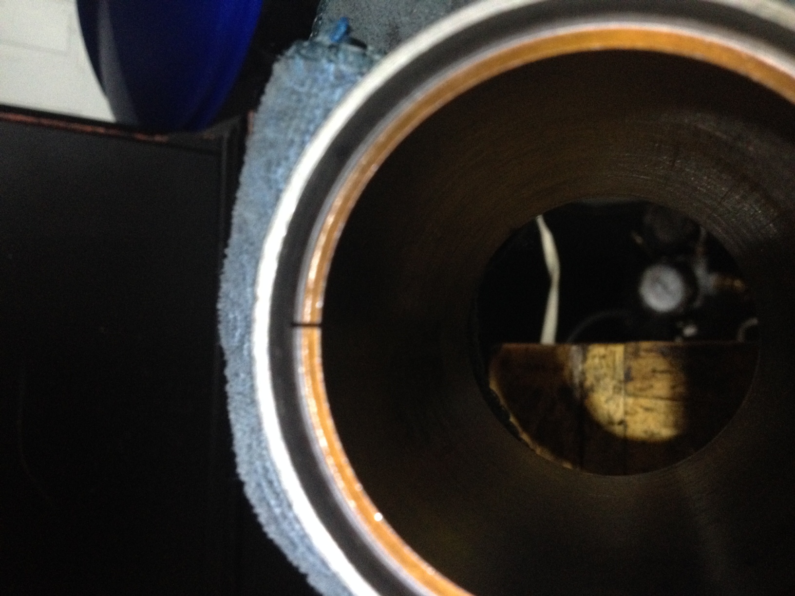

A quick check for fitment is to place a ring into the sleeve ad check end gap. ................lm

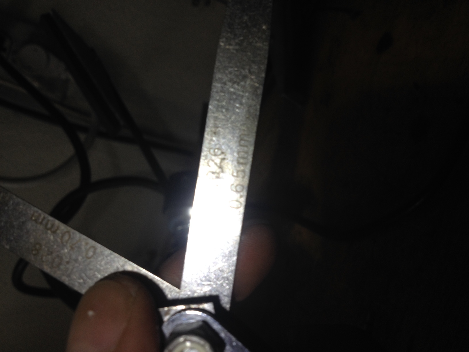

My .026, .65mm feeler gauge was Very snug, and the .70mm didn't stand a chance. Now to decipher what Honda says it should be...

Honda says ".15 - .35" for "second top ring" gap!?!? I'm obviously reading wrong, but if not, I'm screwed! My left good cylinder, after deglazing, peaked at .020 or .5mm gap size. Both gaps were measured with the top ring.

Are you using a new ring or a worn one?
Those figures are 0.15-0.35mm with a repair limit of 0.8mm
Max wear is normally at the top. Try the bottom and compare the two.
Brickyard wrote:Honda says ".15 - .35" for "second top ring" gap!?!? I'm obviously reading wrong, but if not, I'm screwed! My left good cylinder, after deglazing, peaked at .020 or .5mm gap size. Both gaps were measured with the top ring.
