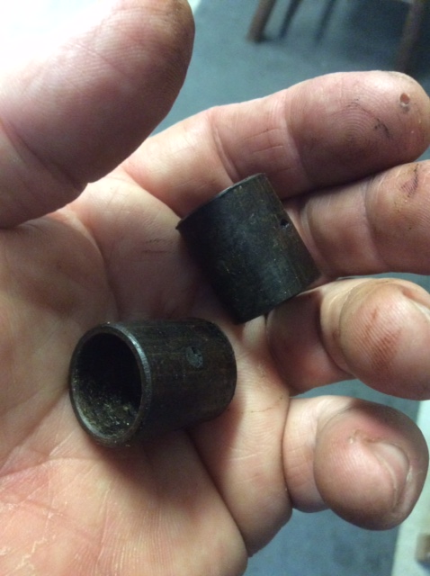

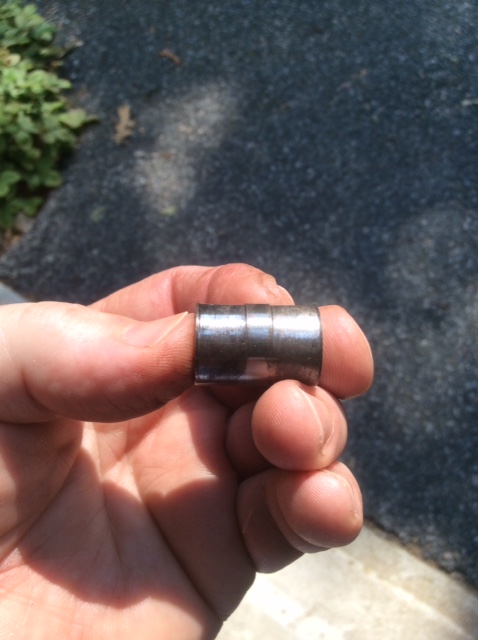

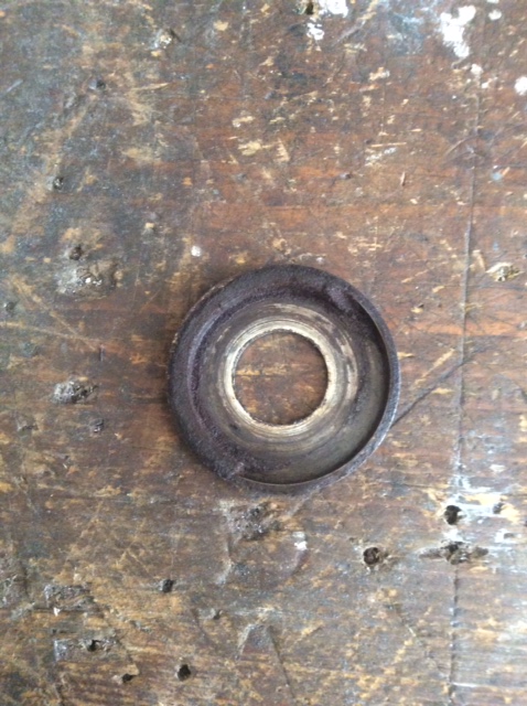

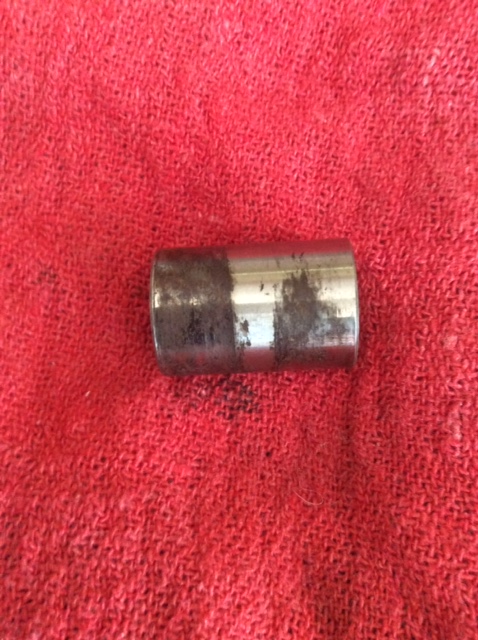

When I was cleaning the floor in my shop last night, I found an end cap to something. It wasn't until later that it dawned upon me what it was - one of the 4 caps covering the front suspension arm bushings. It must have fallen off when I was mounting the front shocks in the fork yesterday. I just never noticed it was gone. So, off the front fork came and the suspension after.
It was a good thing too. Shame on me for not checking those bushings, collars and seals before assembly. They really need replacing. One sleeve was pretty rusted and the other was actually worn in such a way that it was fitting into the groove in the center of the bushing.
Fortunately, Ohio Cycle has the parts and I ordered them today with a bunch of other things. Now I'll have to wait for awhile to pick back up on assembly, but there's plenty to do in the mean time. Besides, I'll need time to figure out how to remove and replace those fiber bushings….
You just have to chuckle.

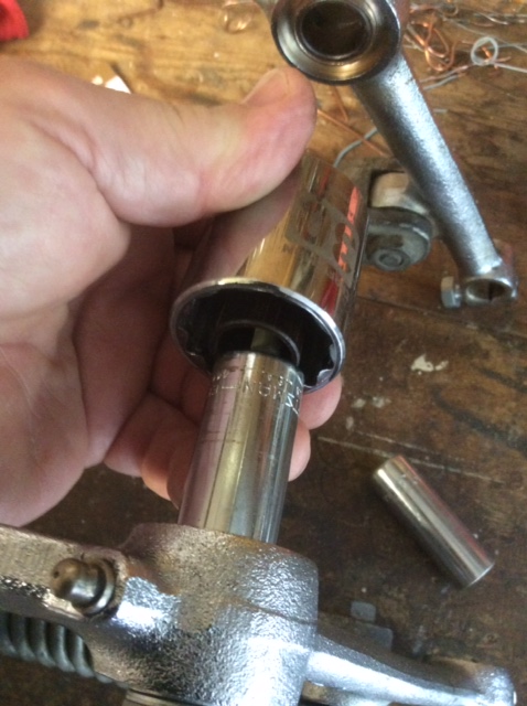

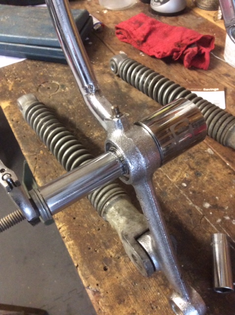

Post by Seadog » Thu Jul 30, 2015 4:30 pm
Necessity is the mother of invention, but now that I have them out (undamaged), how do I get the new ones back in? I'll have to think on it.
Done
Done
Out
Out
Started
Started
Post by G-Man » Fri Jul 31, 2015 12:32 am
Nice solution. They are quite tricky to remove in one piece and I don't think that those fibre bushes do any favours to the handling. I am going to make some bronze bushes for mine and I did enjoy making this little tool to get them out intact.....
The important thing is to support the bush as it goes in or out, otherwise it is going to collapse.
Seadog wrote:Necessity is the mother of invention, but now that I have them out (undamaged), how do I get the new ones back in? I'll have to think on it.
