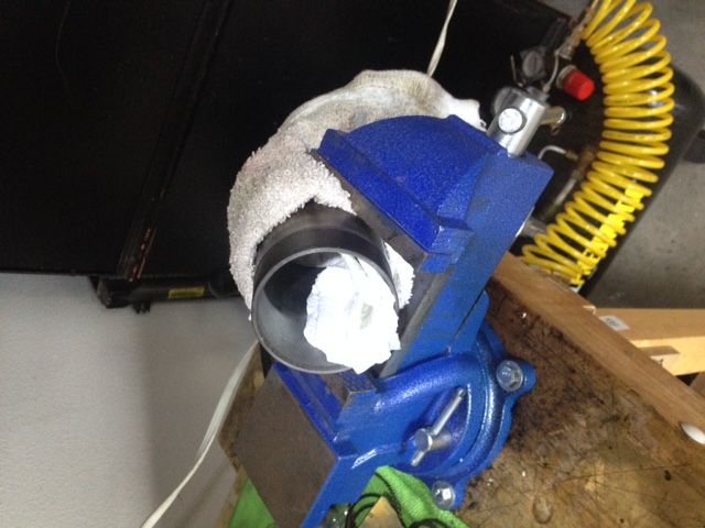

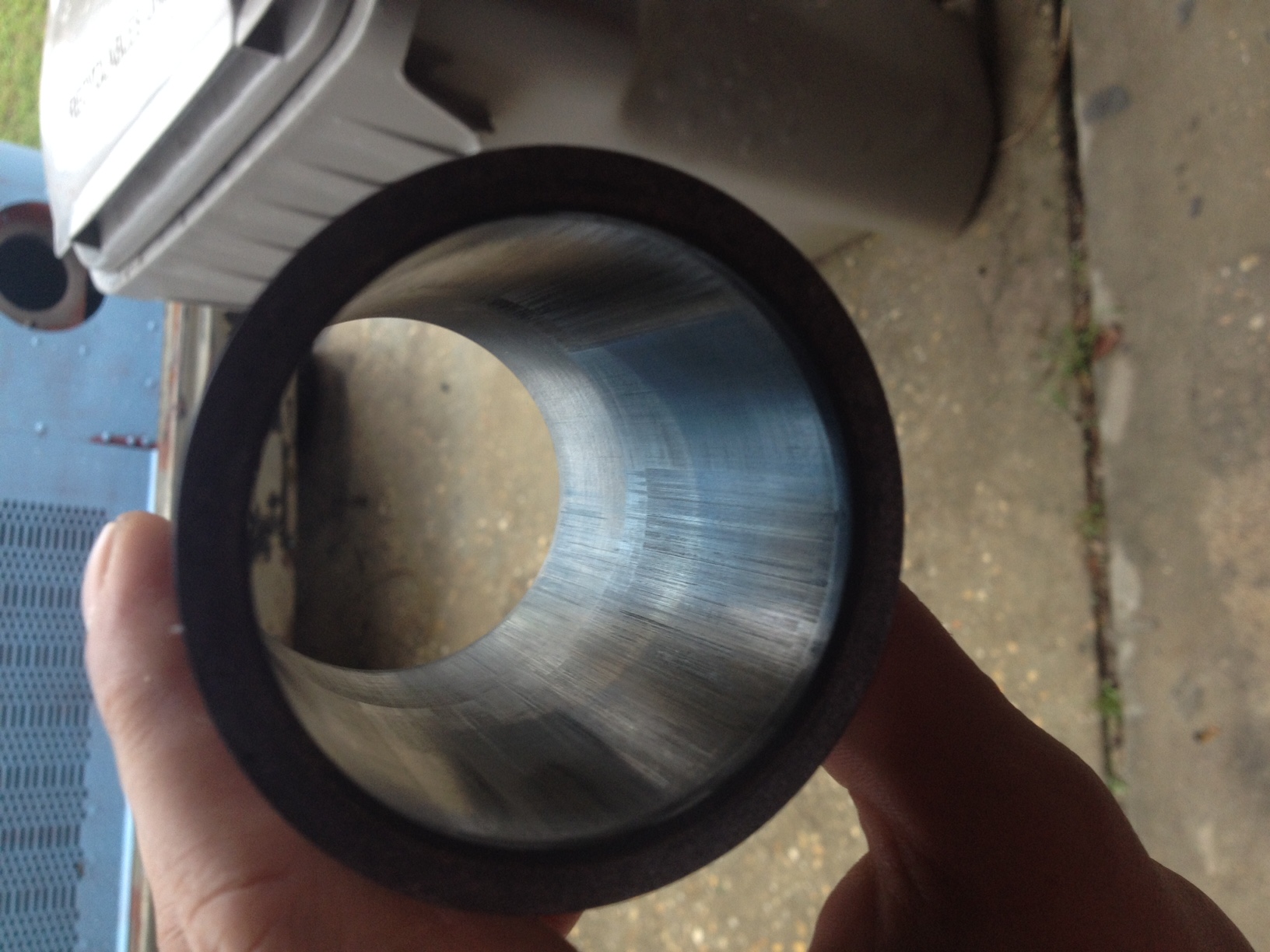

As LM instructed, I saturated a paper towel and left it on the rough area in the sleeve for 3-5 minutes. Then i washed it in a bucket of soap water.
Results: I'm very happy to say the protruding metal has vanished! I can't see or feel it.
Now it's time to deglaze

I used nitrile gloves, insulated goggles and a respirator, and after seeing the smoke with no fire, I'm glad I did!
