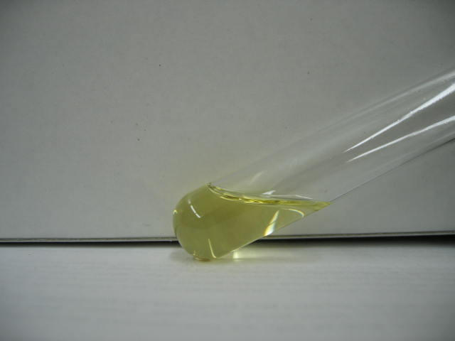

Got home, breather tube was steaming as usual. Now, however, I saw a small drip from the breather about every three seconds. I put a container under the drip and captured the fluid for forensic analysis. It is a clear yellow liquid that smells vaguely of gas but undoubtedly diluted. The photo shows the fluid in a vial...this was the amount captured in about two minutes of idling.
The tapping noise is still there. In fact, as opposed to a dull clacking it has more of a ring to it. like a bell. I can't tell if it's louder from the right side or left.
I welcome comments about the breather condensate and the engine tapping.
