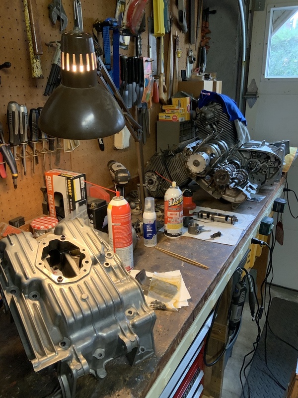

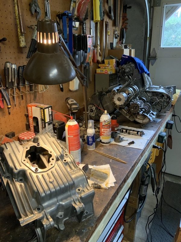

After a long hiatus, I'm back at it again.

Post by G-Man » Sat Dec 21, 2019 5:19 am
Pretty chilly where you are?
That engine looks like it will clean up nicely. Gears look great and the crank appears emininently usable.
Is this the one that you need a frame for? I'm sure one will turn up. I have my eye on a suitable engine for my white 1964 CB77. It's great when things come together.
Let me know if you need any (small) pieces... :-)

Post by Seadog » Sat Dec 21, 2019 6:14 am
Thanks, G. It’s 33 F. here at 6 a.m. Not bad at all. The water keeps us warmer 20+ miles out to sea. It’s 5 F. at my daughter’s house in NW Massachusetts with lots of snow.
No, both engines on the bench are ‘66s. The far one in the photo is done, but waiting for its frame to be painted. The ‘62 engine is in a crate waiting for a frame. I’ve redone its transmission and round bowl carbs, but won’t do more until I know I can do something with it.

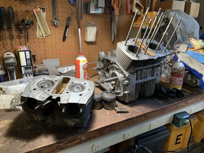

Post by Seadog » Tue Dec 24, 2019 9:45 am
Stripped down the top end. Piston pin clips were rusted solid & the rings were stuck in one piston. Complete redo needed. No o-rings to be found, which probably explains the mass of baked on oil all over.
