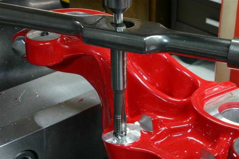

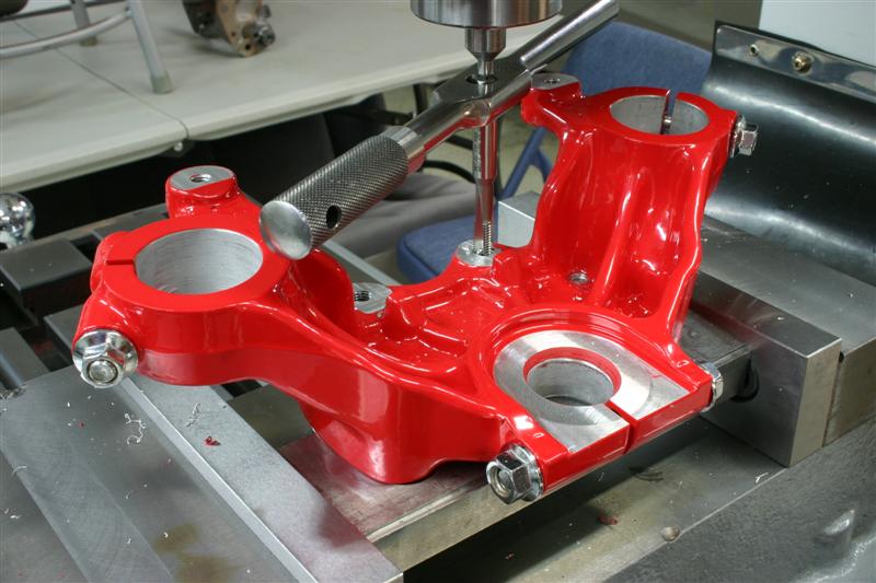

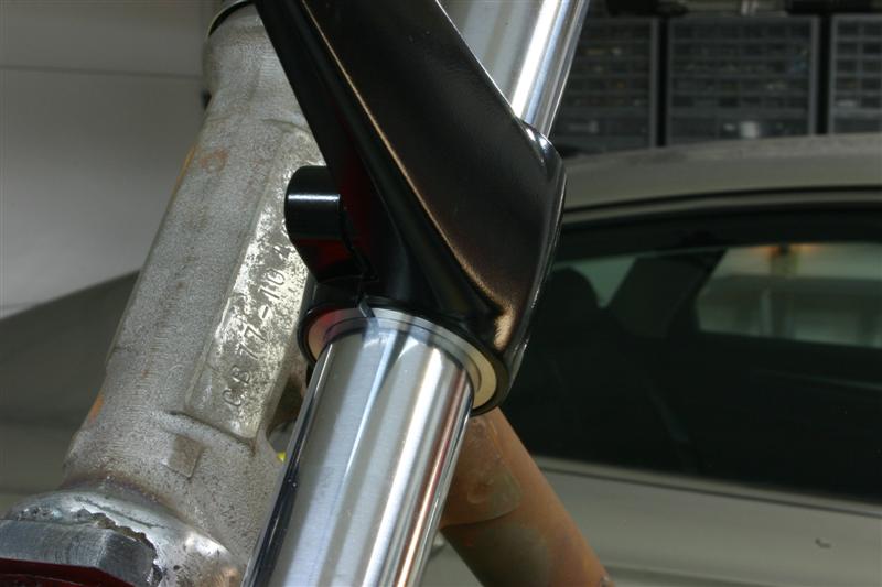

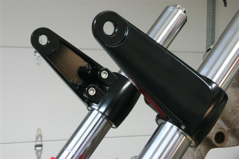

Tackled a few more things this past week - while waiting for the head light ass'y, I did make some reducers for the head light ears. They were for 35mm forks, mine are 33mm. I made the sleeves 33x35, and slit the side. The ears are cast alum and powder-coated.

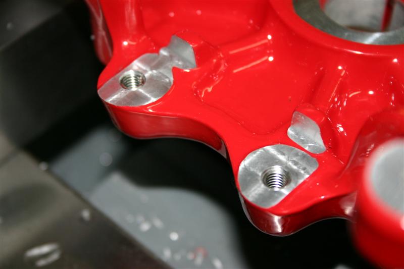

I did some machine work to the top clamp for the tach mount, and heli-coiled the two M-6 holes. This was the instrument location for the CX, but just a cast finish, and kicked up 6 degrees from the stem; the black tach plate that came with the tach needed quite a bit of cutting and it is kicked up 45 degees. I may make some final adjustments when I get the tank, seat, and bars done, but so far looks ok.
