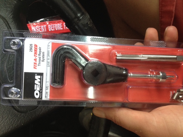

Would've saved $10 on the helicoil buying it online, but impatience got the better of me.
Going to use the 3 stone hone tool on the sleeves since no ones cursed me for bringing it up. Quick back and forward motion, and won't let up off the trigger until the tool is out of the barrel
