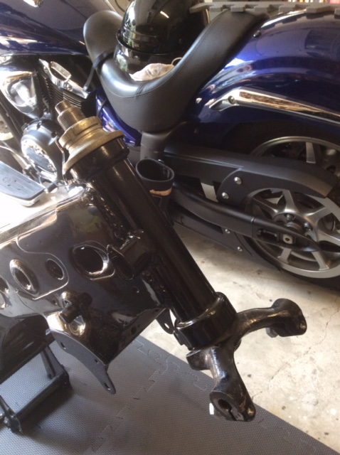

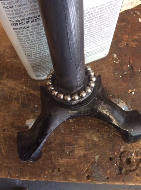

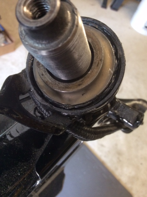

Today, I, the King of Procrastination, started a little reassembly. I was able to mount the steering stem without any real trouble, using the grease as paste to hold the ball bearings in the bottom race and a bungee cord to hold the stem in place while I did the same with the top bearings. I still need a 35mm socket to torque the stem nut. No luck finding one locally.

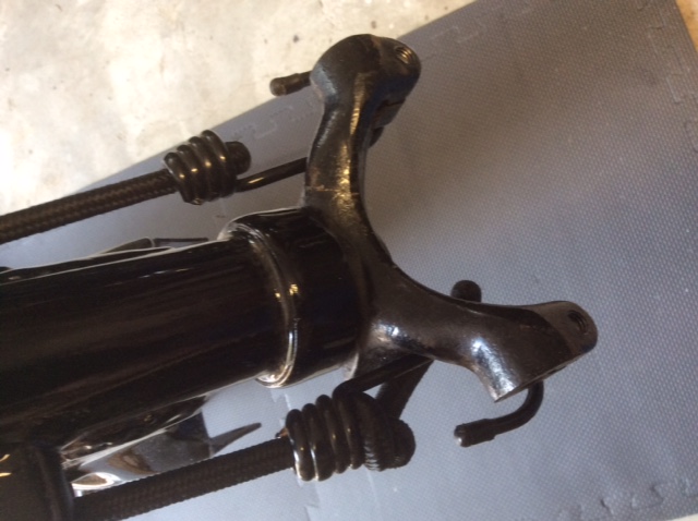

I installed the front shocks and suspension arm into the front fork and although I'd practiced with an old fork, I had a bit of difficulty. I could get one new front cushion bolt in, but the other just wouldn't cooperate. It was as if the shock was twisted. After a lot of jockeying and more than a little grumbling, it just fell into place. Afterward, I was about to mount the rear fork bolts into the steering stem, but decided that they need to be replaced and the lock washers needed to be re-plated. The plating was quick. I'll use the old bolts until I get new. The lock washers dug a nice groove in the new paint though. Why didn't Honda use washers under the locks?
While plating, I decided to re-plate the top bridge bolts. I also stripped the zinc off the bridge washers, annealed the tabs and re-plated them at the same time. The bolts didn't come out so well in the plating process- it occasionally happens. Despite the effort spent in degreasing, I just didn't get it all off. I stripped them again, washed, washed, washed and now have them soaking in Simple Green over night. I'll try plating them again tomorrow after thoroughly cleaning all my equipment and filtering the electrolyte and acid etch.
I also installed the newly re-plated seat bracket bolt parts and the step bar. The bar is NOS and needed tweaking to fit correctly without taking off new frame paint. The lower bar bolts, nuts and lock washers have been re-plated, but because the bike came to me with the engine off, I'm not sure what goes into the upper two holes. Engine bolts or the "bolt, under rear", as shown in the parts diagram? I'll figure it out and will use something else unit I do.
The center stand is painted, a new rubber bumper installed and the pivot bolt, nut and spacer have been re-plated and are ready to install; the kickstand has been replaced with a new used unit and re-plated as have its nut and bolt. I'll be installing them at some point after the wheels are on.
Just a few body parts left to re-plate, such as the rear brake rod and maybe the brake spindle and spring, although they look pretty good as is. Engine parts will be dealt with later, when I start work on that (I need more procrastination time).
All-in-all, perhaps just small progress today to those more experienced than I, but satisfying for me nevertheless.
