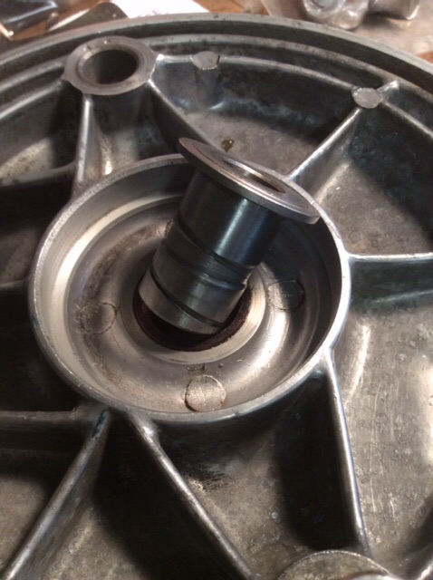

Gas tank is back and looking good. Wheel bearings and seals should be delivered today and I'm preparing the front and rear brake panels for shoe installation. I removed the front spacer panel to clear out the old grease and it got me wondering why it fits so tightly - I had to drive it out. Can anyone educate me on why it's a greased part if it can't move? Should it be able to spin?
Anyone recommend a good bearing driver set?

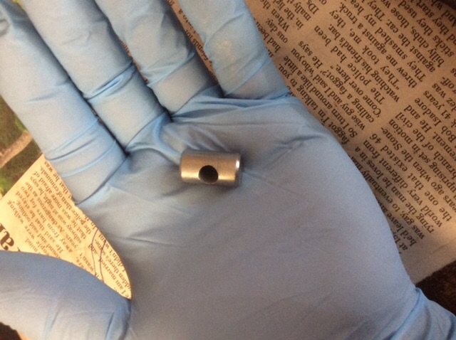

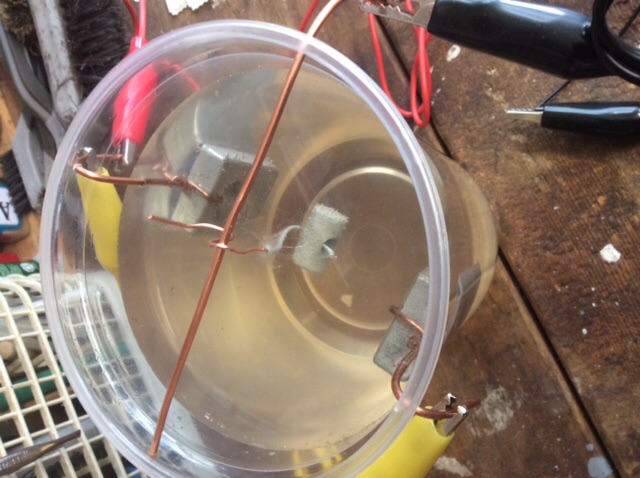

Started zinc plating today. I chose a small very rusty piece as a test. Unfortunately, I didn't think to take a "before" picture, but I did take a "during" and an "after". Lots more to do and a bigger tank will be needed.

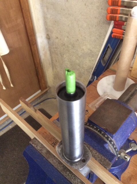

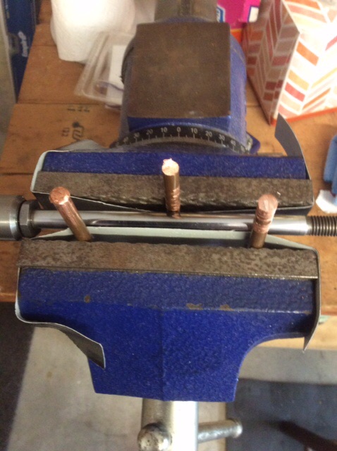

I've spent days cleaning and zinc plating parts, but have so much more to do. Wheel bearings are installed and I've finished replacing shock seals and oil. I also had to straighten both shafts, which really wasn't too difficult.

Thanks, Sara. I'm plodding along. I've temporarily stopped plating while waiting for a new DC power supply to arrive and other projects have taken over for now.
