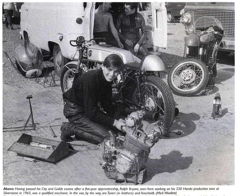

I found this picture in Classic Racer yesterday. Wouldn't it be great to build a time machine and just hang out with these guys......
Ralph Bryans CR72 small .jpg (93.59 KiB) Viewed 23340 times
