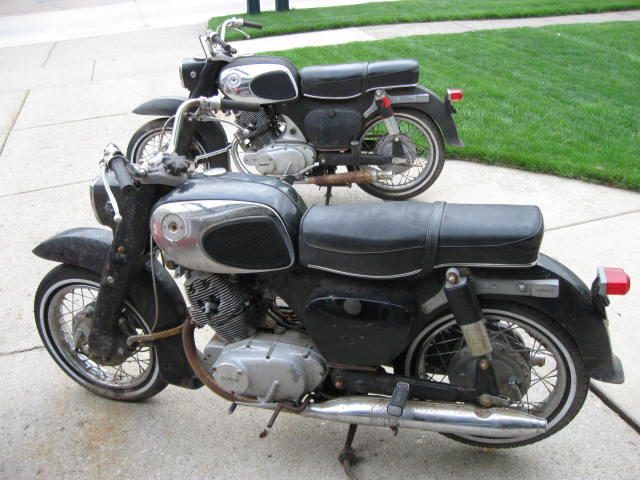

Hello all,first post,first bike restore.Just picked up two 305 dream Ca77 1965,looks original.Was going to flip ,but now want to restore/get running.Has been sitting for years.Poured oil in cyclinders,changed oil,new pluges,good compression.What carb kit manufacture should be used/stayed away from?Where is the best place to purchase parts?
