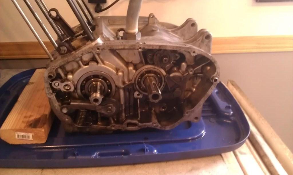

Here are some pictures--tell me if I have all the bolts out
ok, here are some pictures---I have 4 total. When you say the top two bolts are you sayng the ones in picture 4 that hold the bracket for the painted piece that goes over the wiring?
By looking at these pics, can you see anything I missed?
Thank you.
Thank you.
Re: Here are some pictures--tell me if I have all the bolts
Actually now is the time to remove All parts while they are part of the engine and can be removed easier. .......lm
