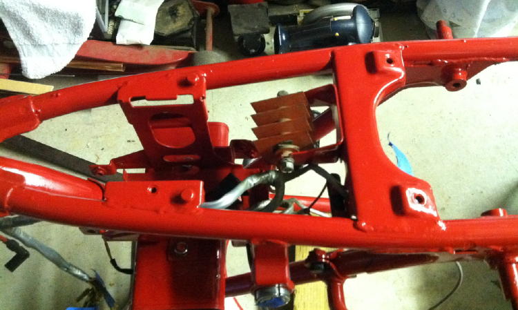

Does the 1966 frame come with a welded seat mount for the front of the seat to fit into? I'm looking at this frame and there is not mount for seat, what's the deal?
frame/seat
Does that mount near the gas tank? Do you have pics of the part? So the frame should be okay for this year? I have another frame (68) and it has a "latch" up front for the front of the seat to slide into.

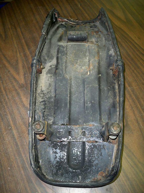

Early/ Late seats
There are early (65) and late (66+?) seats for CL's which changed at frame number 1033481. Make sure which frame and seat you have first. They mount differently.
