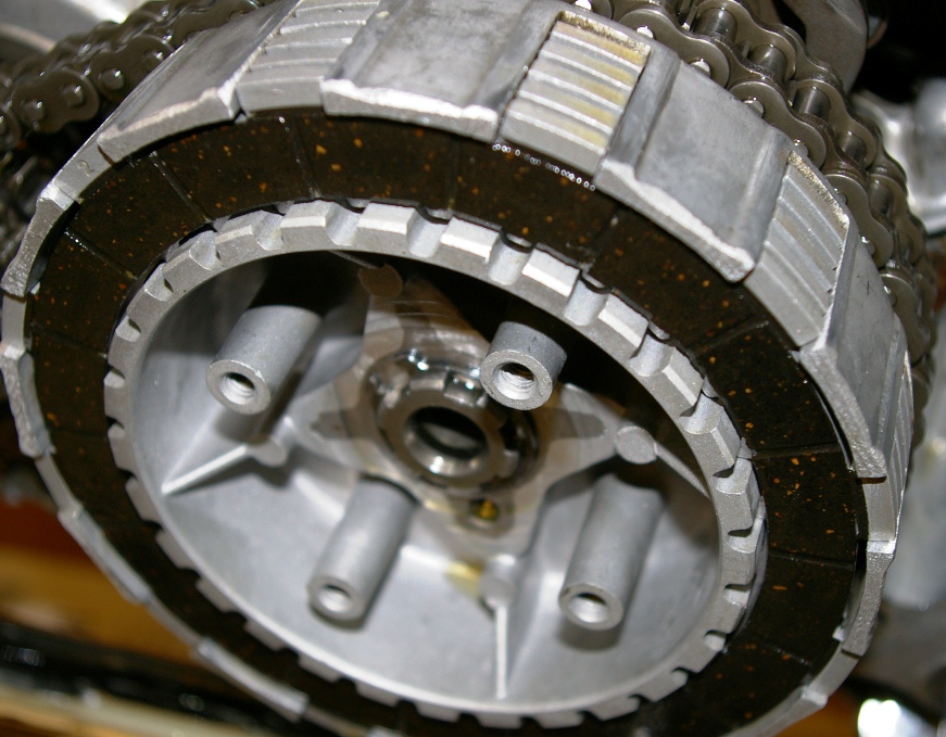

I finally buttoned up my new clutch today--it took some work, but I think it will be a big improvement.
The first pic shows the replacement parts: pressure plate, friction discs, clutch plates and center from lm, and the 2 plate stopper wires from rrietman--thanks guys!

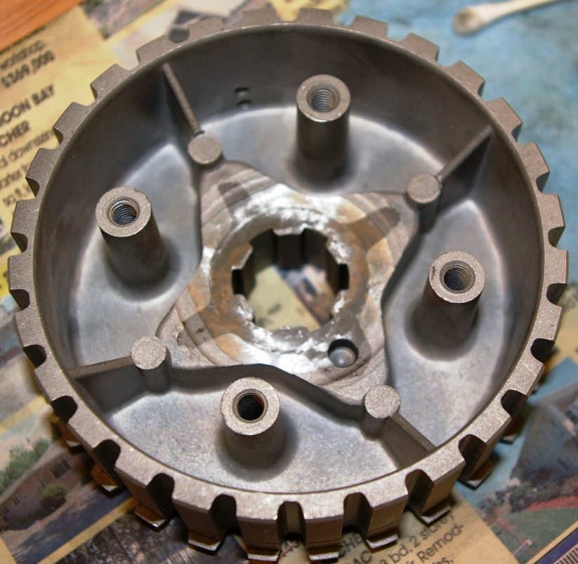

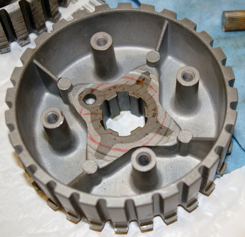

The installation was going great until I couldn't fit the snap ring into the groove on the drive shaft. There just wasn't enough groove for the ring. I compared my old clutch center to lm's replacement, and after some measuring, confirmed that the spline depth on my center had been reduced by a second 'relief cut'. The red marks show where I decided to machine the new center, reducing its thickness at the spline by about .025". You can see the lack of sufficient groove for the retainer ring on the drive shaft.
The newly machined relief on the replacement center looks awful, but that's mostly glare and camera flaw! The last pic shows my new clutch pack installed and ready to button up.
